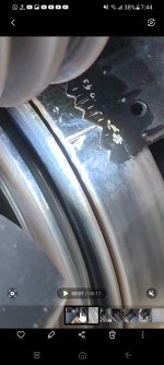

Ok thanks. I'll include the pic on my timing mark on my TBiv 4.3. I'd say I'm 6° too advanced...does that look correct?

How are you doing this with a screenshot from a cell phone? Was the engine turning when you took this picture? If it was and you just captured a video frame and this is indeed when the #1 cylinder fired, then it looks to me like you're about 1 or 2 degrees advanced BTC. I think I can make out an "8" and the increments are 2 degrees. If your engine calls for 10 degrees and you're firing at 2 degrees, then you're 8 degrees retarded, not advanced. Again, I'm not sure what your engine calls for at idle just using 10 degrees as an example.

I'll see if I can attach the video.
