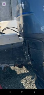

Here is a few issues saw

No water spashes up on the deck. Right behind the transom is all sloped up. My bilge does have to pumps however hooked together, I will change that.

The crappy thing now is that my deck won't drain rain water and it rains alot here during winter months
