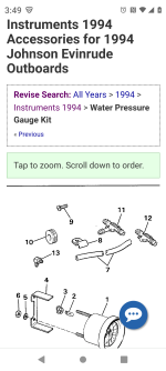

By the way, motor doesn't come with the pressure sending port for the head, it comes in a kit with the pressure gauge. Your right, someone probably removed it.
saltchuckmatt
Jul 19, 2019
3,287
Just looked up your engine, part 13 says it's mounted on the exhaust cover. Look for a small 90 there.

Moving the tell tale to the top of the engine was on certain 3 cylinder motors. ---Does not apply to your motor !!----Post #10 shows how a factory pressure gauge would be installed.
