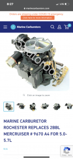

As I look to replace the carb, looks like Rochester / Sierra have a new designed carb with a rear port. Not sure what or how this would work on mine. Is it a vacuum type line?
Picking up money from the marine shop Monday and I’ll order a new carb.
Might be a stock photo, could ask the vendor. You don't need the vacuum line and it could be capped
