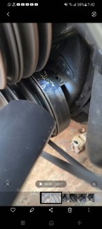

Hmmm yours looks like mine. Good to know. Thanks. How's mine look?

Sorry forgot to respond. Scott06 is correct. When you bump your timing the rpms will likely increase. reset idle and check timing again.
Don't I have to retard it 6°? I would have thought the rpms would drop no?
Scott06
Apr 20, 2014
7,375
Im pretty sure you need to advance it 6 degrees to 8 degrees before. Your crank shaft will be turning clockwise viewed from front of engine.
dhrmx5
Aug 3, 2021
12
The scale shows BeforeTopDeadCenter also known as BTDC. You should set it for 6-8 degress BTDC, depending on the quality of the fuel you run.
dhrmx5
Aug 3, 2021
12
In response #6 I mistakenly used the word peaks when I meant marks. Each mark is 2 degrees.
