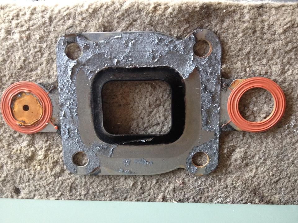

Anyone know why the forward port on this exhaust riser metal gasket is restricted??

Answered my own question...."The purpose of the restrictor hole is to prevent the cold bypass water as it enters the exhaust elbow, from back-flowing down and into the manifolds. If the restrictor hole is positioned incorrectly the cold bypass water will flow downward into the manifold and prevent the manifold temperatures from heating up enough to prevent condensation."

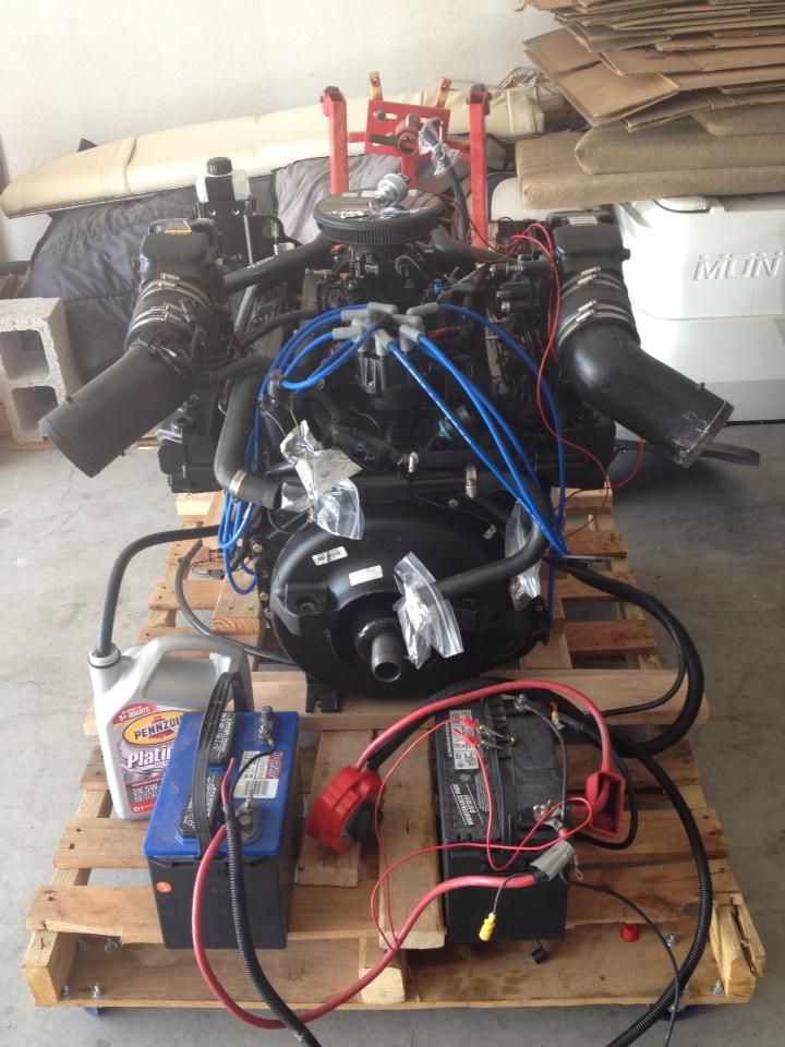

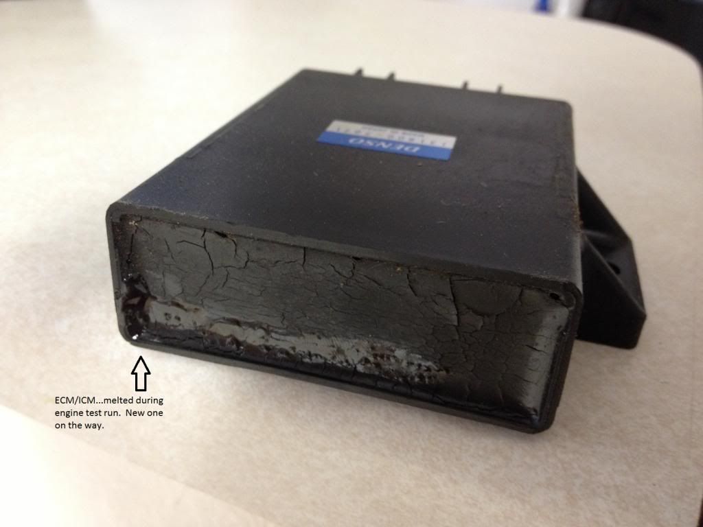

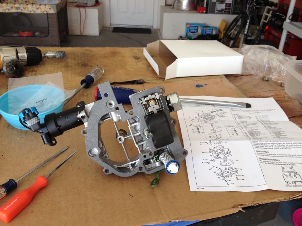

Got the carb rebuilt. Had some overflow/flooding issues but a simple float adjust fixed it. Ran the engine out of the boat today. started right up and sounded great but for some reason the ECM fried...literally melted. Good thing those are cheap!! (not cheap at all)

I need to check there is not a short to power

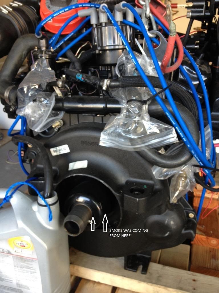

Was running the engine and sounded like it was going to sieze and a little smoke came out (see picture) any ideas? maybe oil pump?

It could be a rear oil seal leak or the seal could have been dry and burned up on start up.

would that make the engine sound like was going to sieze up? i shut it off as soon as it started.

Have you checked the engine oil level?
