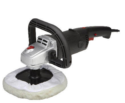

Get some of this...
autogeek_2232_4599674
and one of these from Harbor Freight
On sale now for $29.99
Go easy and run the polisher on medium speed and in no time she'll look good as new
