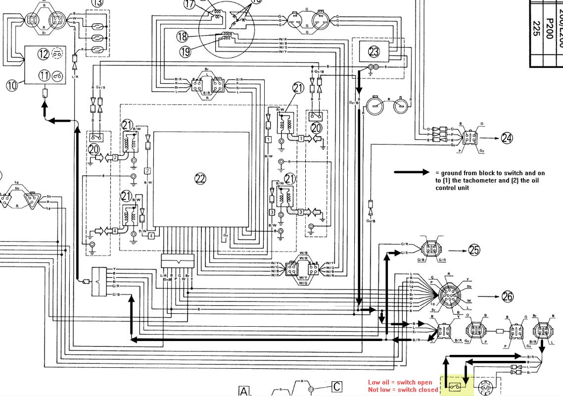

I have checked continuity with the harness from the sensor on the remote tank (under console) to its connection under the cowl. No breaks in the line. Where is the sensor switch grounded? Should I check to see that the sensor itself is working and how do I perform that test? The sensor on the main tank (engine) seems to be operating correctly. It throws the alarm when the oil level drops to bottom line on the reservoir

Thank you for the diagram! Forgive my naive questions here, black/red and black is the circuit i need to be checking that goes to The blue connector under the cowl? From that connection it should ground to the block somewhere, so just follow that and ensure that ground has good connection to block and free of corrosion? Is the switch you are referring to the sensor? Is it possible my sensor/switch is bad? Thank you for the reply.

Black to the switch. Black/red from the switch. From the blue connector.
Notice that at a junction point with the engine harness the B/R turns to green/black. G/B to the oil control module and G/B to the oil connector (#25).
The switch referred to is within the sensor switch assembly located within the remote oil tank. Certainly it can fail open.
With the remote tank full of oil you can test for continuity at the sensor switch connection points.
Try this. With the key on, jumper a ground wire from the engine block to the B/R terminal pin in the engine side blue connector. See if the lamp changes from yellow to green.

Ok, continuity at sensor. Connecting blk/red on engine side to ground with no change.

Guys! Thank you for all the help. After chasing wires and connections, it ended up being where the blk/red connects to grn/black on engine side of harness. I should have checked continuity from blue connector engine side to the round connecter where the black/grn plug into the oil controller. The wiring was very brittle and fell apart as soon as I tried to remove the heat shrink. Reconnected and light went green!
