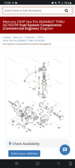

Didn't know I made two posts I'm new to the forums sorry...pictures below also with my carb/choke diagram

Pic #2 has your idle screw in it. Try turning that down have you done a compression test?
Johnmerc98
May 20, 2023
17
It's backed out to where the shift linkage isnt touching it and I was getting 130psi cylinder 1&2 I checked reeds I checked vacuum lines for leaks the only thing I can think of is air/fuel mixture screw adjustment is wrong
