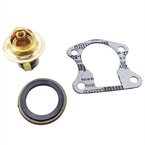

Also I have been buying quicksilver parts but it seems the gaskets are not in some sort of package and something like this looks to be cheaper. Would this be a suitable kit ? Thanks
jerryjerry05
May 7, 2008
18,196
That kit would work.
The best bet is buy products that say Mercury/Force on the package.
China has made so much junk, you never know what your getting.
Measure the temp next to the plug on the head and along the pistons travel or side of the cylinders. Hit a bunch of places and record the results.
tg3690
May 7, 2019
1,121
Agree with jerry 100 percent......Sierra would be acceptable as aftermarket brand IMO.....and a little cheaper than Quicksilver. Just look at the brand names in the product descriptions on ebay......the one in the link above states it is "UanOfcn"......sounds very Chinese to me......
