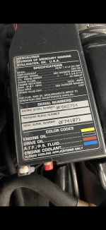

1996 mercruser 7.4 mpi LX.. I replaced throttle position sensor and I still get a code. Once I replaced it I cleared the code. I put the boat in the water fired it up and let it run a little while. I repeated the process several times but when I go to check for codes I get the code for throttle position sensor. Will this go away after I drive it a few times on the lake? I also notice a higher than normal idle too.. the sensor has two screw holes so I don’t thing this can be adjusted.. any advice? Thanks.

Your engine bay looks immaculate. Good job Cpt.
