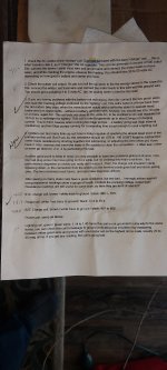

Hello group, I recently bought a couple of used Waverunners, a 95 WRA700T and a 96 WRA650U. The 650 will fire right up and idles just fine, but it will not rev up. The ski is on a trailer and has a water hose connected. Both cylinders have 125 psi compression, I have confirmed that there is not a fuel starvation issue, I have also confirmed that the spark plugs, ignition coil, wires, and carburetor are all in good working order. I found a diagnostic test online and found that all voltage and resistance readings are all within spec. (See attached) with the exception of the pulser coil, it is supposed to have 4 - 5 VAC, mine only has 3 VAC
Thank you in advance for any assistance that you can offer.
