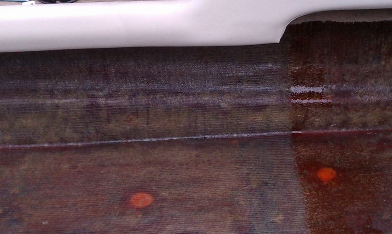

The first layer of CSM was going down pretty good. What I didn't count on was the sun peeking out from around the garage. Before I could get the CSM to fully wet out and smoothed down, the resin gelled. Out with the grinder, and a little better planning for next time. The 1208 went down nicely.

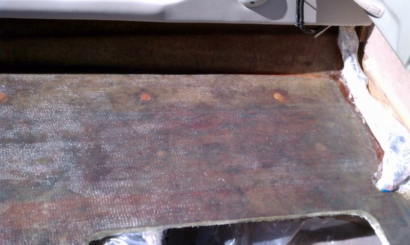

The next layers when down without a hitch. I sanded a bit between coats to help level the deck.
