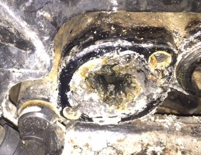

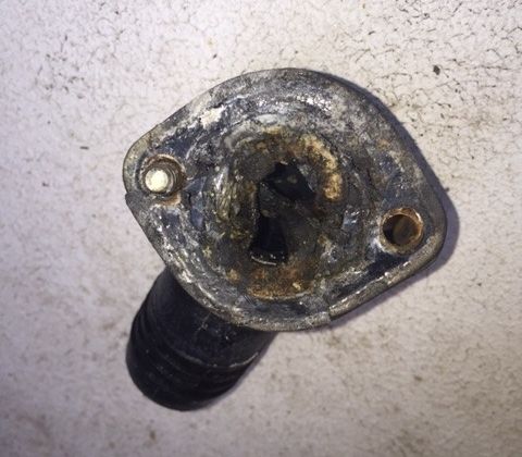

Bt Doctur
Aug 29, 2004
19,566
Would I still consider this if the system was flushed after every use?
Definitely what happens is the alum housing build up corrosion and forces the opening closed.his is from a Fla boat that was stored indoors for 3 years.
45Auto
May 31, 2002
2,842
Those pictures Alldodge posted were from my boat last year, on the thread below. My boat was doing the exact same thing you describe. It's so common that there's a name for it: Bravoitis.
http://forums.iboats.com/forum/engin...rc-7-4-bravo-3
It's a 2003 Crownline 225 with a 496HO, flushed every time it's taken out. Had 390 hours on it as of last weekend. Been in saltwater once in it's life for a weekend, when we took it to watch the airshow from Pensacola beach about 5 years ago.
I changed the water inlet for the Hardin kit without removing the engine. It was a major pain, description of the process is in the thread linked above.
There's a couple more pics of the drive with the hose and fitting removed in this thread:
http://forums.iboats.com/forum/engin...mostly-at-idle
Good luck!
