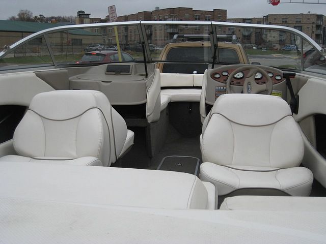

Future plans are to change seating to a bench/sundeck style rear configuration, Add swivel captain style seats at helm and port side front, instead of back to back type.
Then find a Donner 4.3 mpi,, 5.0 or 5.7, and re-power/gear the boat. I know, I know, just buy a boat made like this... But I want it in my boat.:D
Here are some pre-resto photos

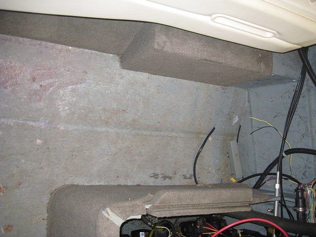

Carpet Adhesive removal frustrations...
Well so far I've tried 4 techniques.
Goof Off Citrus crap: Makes glue boogers, you cant scrape it at all, and water is needed to clean off... PITA but smells good.
Mineral spirits: I think this solubilizes everything including the fiberglass resin and old paint into one sticky mess...
Methyl Ethyl Ketone. Eats Nitrile gloves, even with a respirator this stuff seems like liquid death... It removes the glue, but I'm not sure if I want to go this route. I'm unsure if I just poor the crap on the deck and sop it up with paper towels?
I've tried a paint scraper with good luck, but still feel residue is left over and my compromise Durabak adhesion.
My friend is bringing a grinder to work tomorrow, so I my try that, and wipe remaining residue off with acetone.

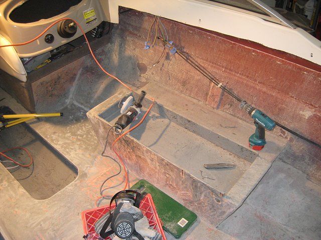

Update:
Grinder with cup wire brush makes short work of carpet adhesive, plus also grinds, and helps shape sloppy factory fiberglass/resin spills...
Decided to not glass for now.
Will do some patch fill work with formula 27 mastic /plastique filler, sand and smooth out rough spots.
Poly coat raw unprotected wood knots and such other bare areas..
I still plan on using durabak not only on the deck, but also the seat boxes, engine compartment, and side wall of the bow. I'll either roll, or possibly sprayed on. Spraying may be good for filling imperfections.
I'll either go with off white / cream color, or light grey...
Then cut templates from old carpet, get new carpet binded, add snaps, and off to electrical project.
If anyone has any comments or advice, I'm open... Never done any of this...
Here are some pics.

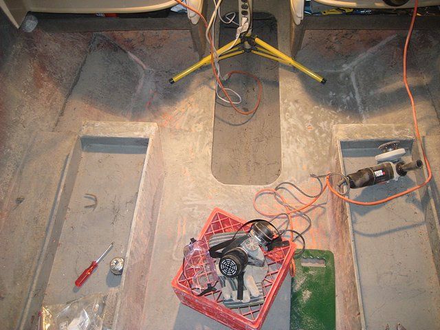

Update.
grinding away... Needed new wire cup brush today. Also a second grinder... Sounds like the first 24 hours have beat the first one to death... Got them on sale $30 ea. glass cannot be good for electrical motors...
Here are some pics.
The seams that opened up while grinding.
Decided to remove all carpet. This way I can roll or spray Durabak further up the sides, then use the carpet to create the border... I plan on adhering carpet back on the sides of the boat...
