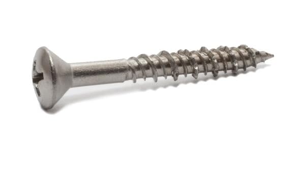

Stainless staples for sure. I don't scratch up the surface of my decking before gluing on the vinyl and I know the SC factory glues carpet to the sides of brand new shiny aluminum which has to be more slick than spar on plywood.
Screws are not the best option but frequently used here, I guess easiest since they're readily available. As done by the factory most times, large flange rivets are best for anchoring the decking to the ribs, the screws only hold by a couple teeth in the thin AL and will work loose over time way sooner than rivets. There's 2 ways of putting on decking, attach it and then put covering on or wrap each piece and then attach. It's your call, either is acceptable but screws will pierce the carpet and leave a hole unless you use screw washers if you wrap first.
If your set on using screws then I believe these are the best after using them I find they don't let go of anything easily.
Sharkx SS marine deck screws

Thanks Watermann!!
The factory floor panels were screwed down with these:
I really want to use screws so I can pull the floor up.
I am going to wrap each piece then put the panel down. I was just thinking about drilling the holes for fastening first so I can put some spar in them.

Not a single one of my deck screws in two restores has loosened in 8+ years. Had issues with some of the machine screws holding trim and what not on but the deck screws have been perfect. I installed my deck boards and then touched up all the screws with more epoxy and then applied my vinyl flooring in the boat. I can understand your wanting the boards to be removable but I think you water sealing is gonna be a real trade off. I used stainless staples from Lowes for any and all stapling and they've held up.

Oh I see, yeah those are some really fine toothed SS self tapping screws. They would work way better than what guys find in the big box store. They use those to save time, no pre-drilling I guess. Drilling first, wrapping and once again finding the holes to drive a screw may be a bit tricky.
