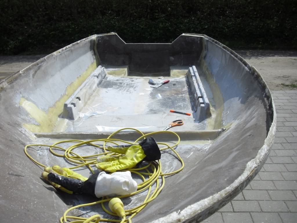

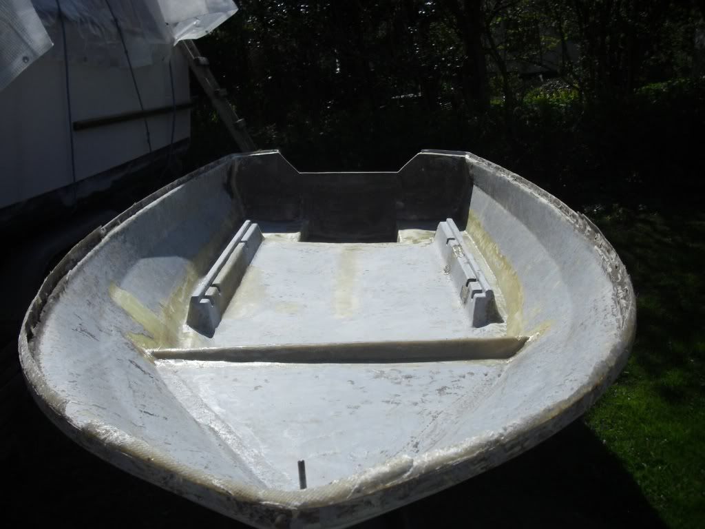

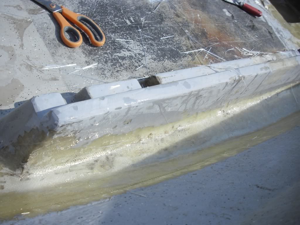

Yesterday I managed to get the remains of stringers glassed.
So today I only had a little preparation to do before I could glue back the floor. Meaning grinding a cleaning with acetone.

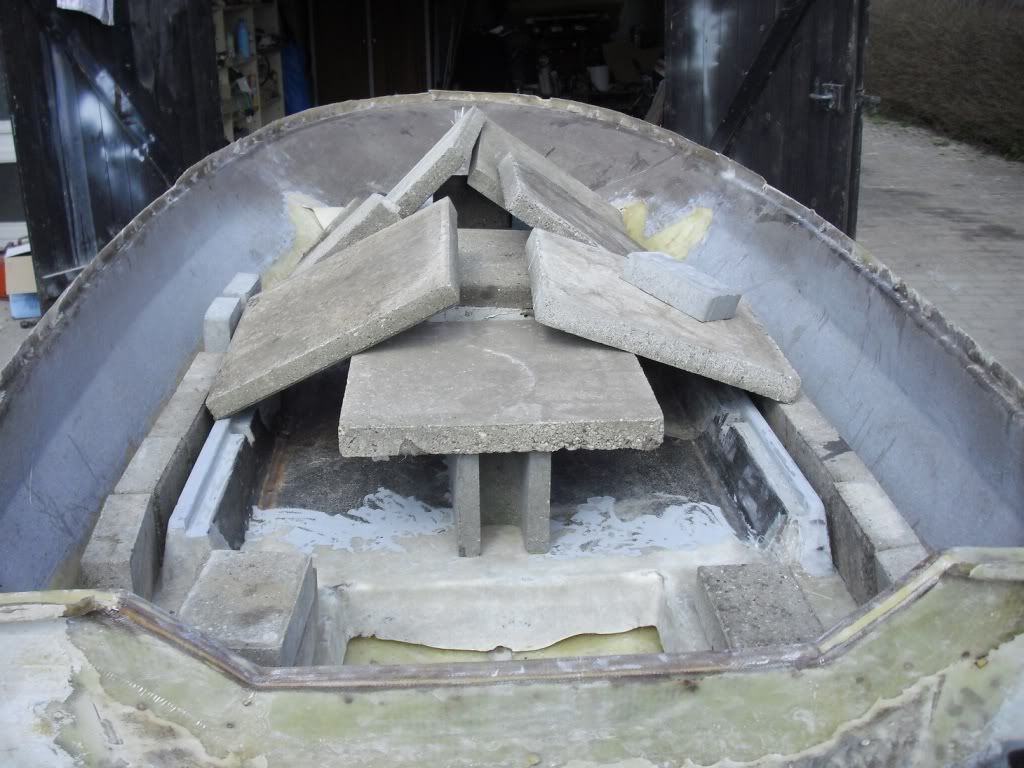

The floor and the stringers were pasted with epoxy and put together with distributed pressure, to follow the bending in the floor, basically the middle stringer is about half an inch lower than the side stringers.
Next up is glassing the floor to the hull, most preparation is done (grinding!) . Then I need to look for appropriete paint for the entire inside of the hull. I think it'll be epoxy primer followed by 2 part polyurethane.

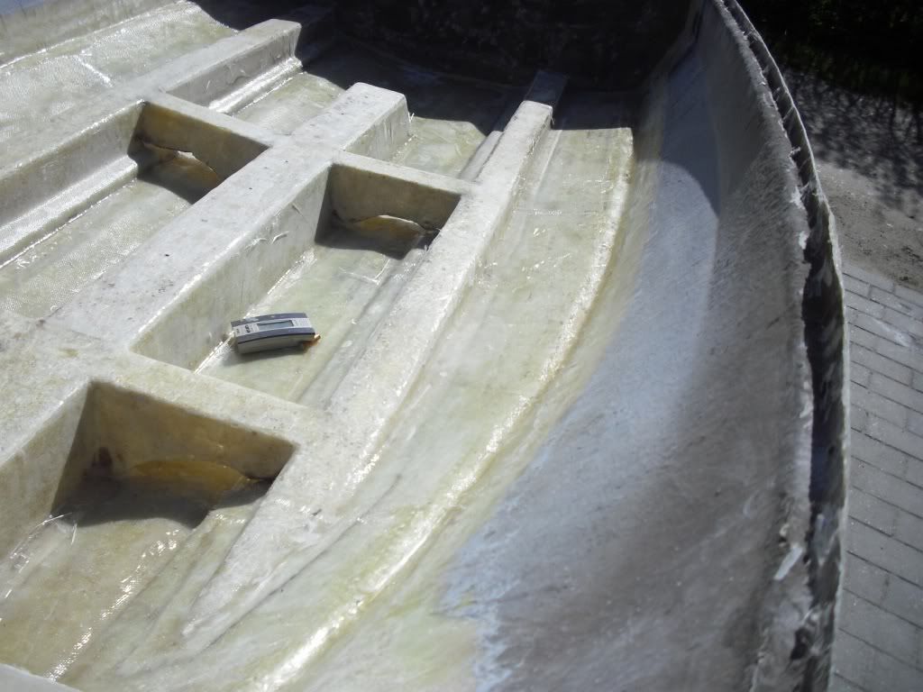

Outer stringers got their final glassing on the outside.
Floor grinded and cleaned for the touch down on the stringers and sides of the hull.
Epoxy applied to floor, stringers and sides of the hull and weight distributed to get full contact.

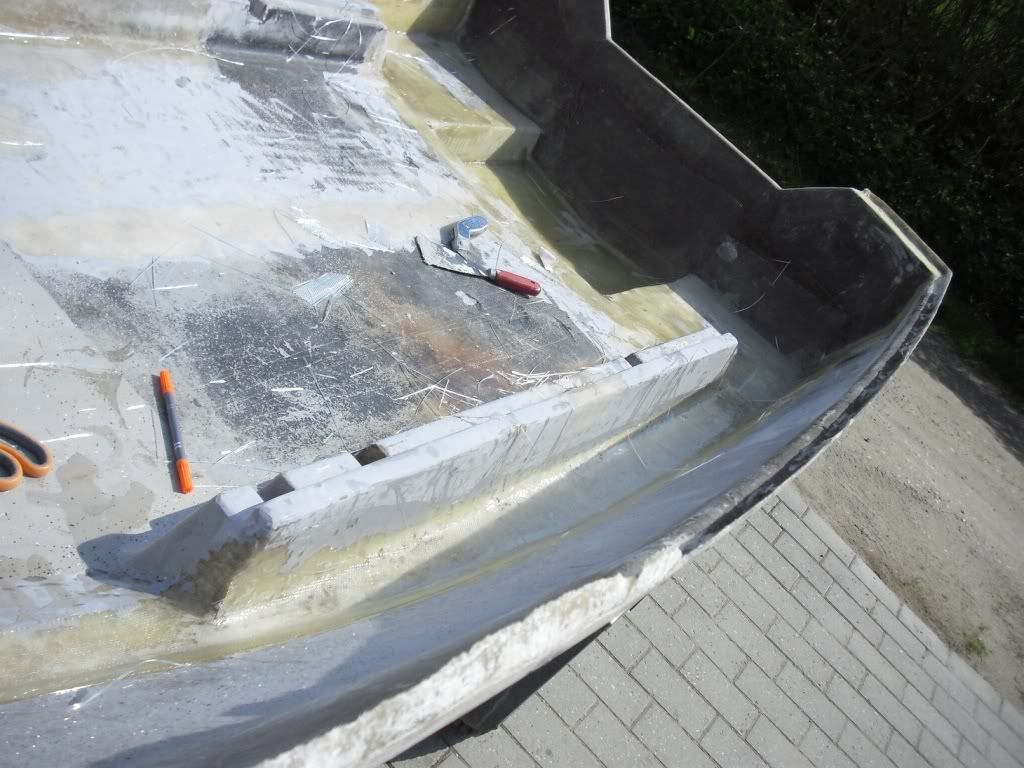

After the epoxy cured, the weights were removed and the boat now feel rock solid :) I noticed even when putting the weight on that the hull (before the epoxy was cured) it would not bend/flex on the trailer supports, it did when I first got it without any weight on (just lifting the boat and putting it down). When I glassed the hull and stringers I had to add support directly under the transom to avoid re-shaping the hull.
So I am taking it as good sign.
Yesterday I filled the joints between the floor and hull with epoxy mixed with microballoons and today after a quick grind up (and the neighbours complaining about the dust/smell :/) I glassed the joints to the hull with overlapping layers of woven roving. Also grinded the splashwell end that connects to the transom.
Next up is grinding the gelcoat inside the hull and paint it with 2k epoxy primer. I'll try to get the remaining grinding done aswell (outside of transom) so I can have peace with the neighbours after that, as from then on it will only be minor grinding :)
Happy easter guys.
Joints filled with epoxy putty and glassed with overlapping layers of woven roving.
Another angle.
Overview. Next up grind the grey gelcoat and excessive epoxy then paint with 2 component epoxy primer.

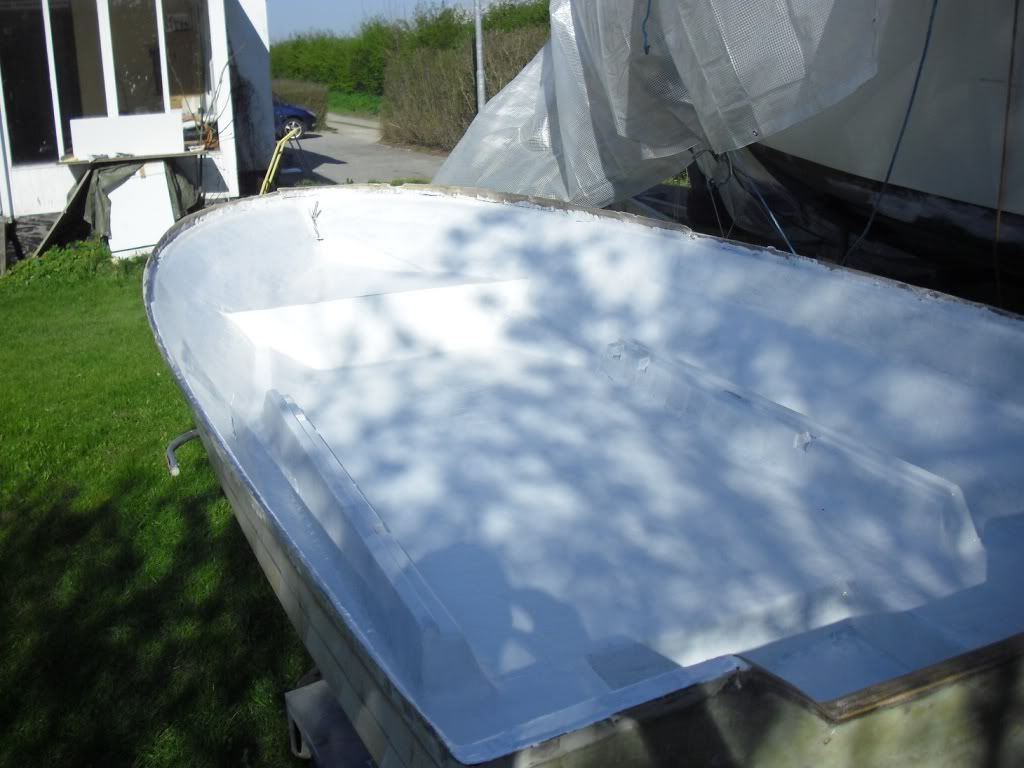

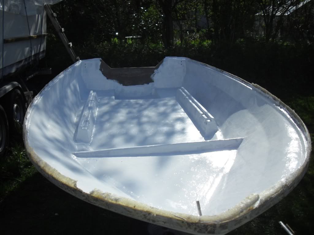

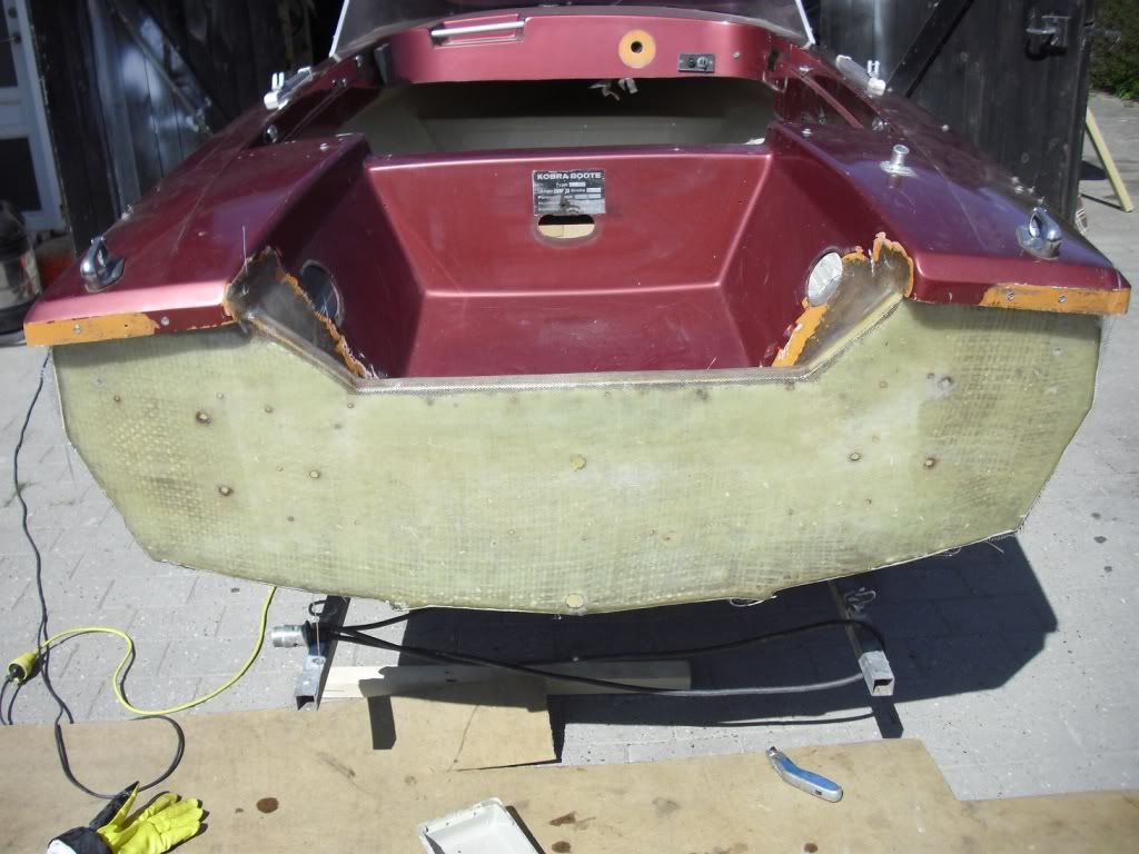

Got the grinding of the outside transom and inside hull done, quite happy as this was the last major grinding needed.
After vaccuming and cleaning the hull with acetone 3 times, it was time to paint with epoxy primer. I used a foam roller, unware it would detoriate after awhile, luckily I had two and made it to the end (barely). 1 Liter (0.26 gal) of epoxy primer was used, and I think it covers pretty well with 1 layer.
Now I have to let it cure for about a week, before I can paint on the (grey) 2k polyurethane after a light sanding.
Inside hull grinded and ready to be painted.
1 layer of epoxy primer applied.
Another angle.

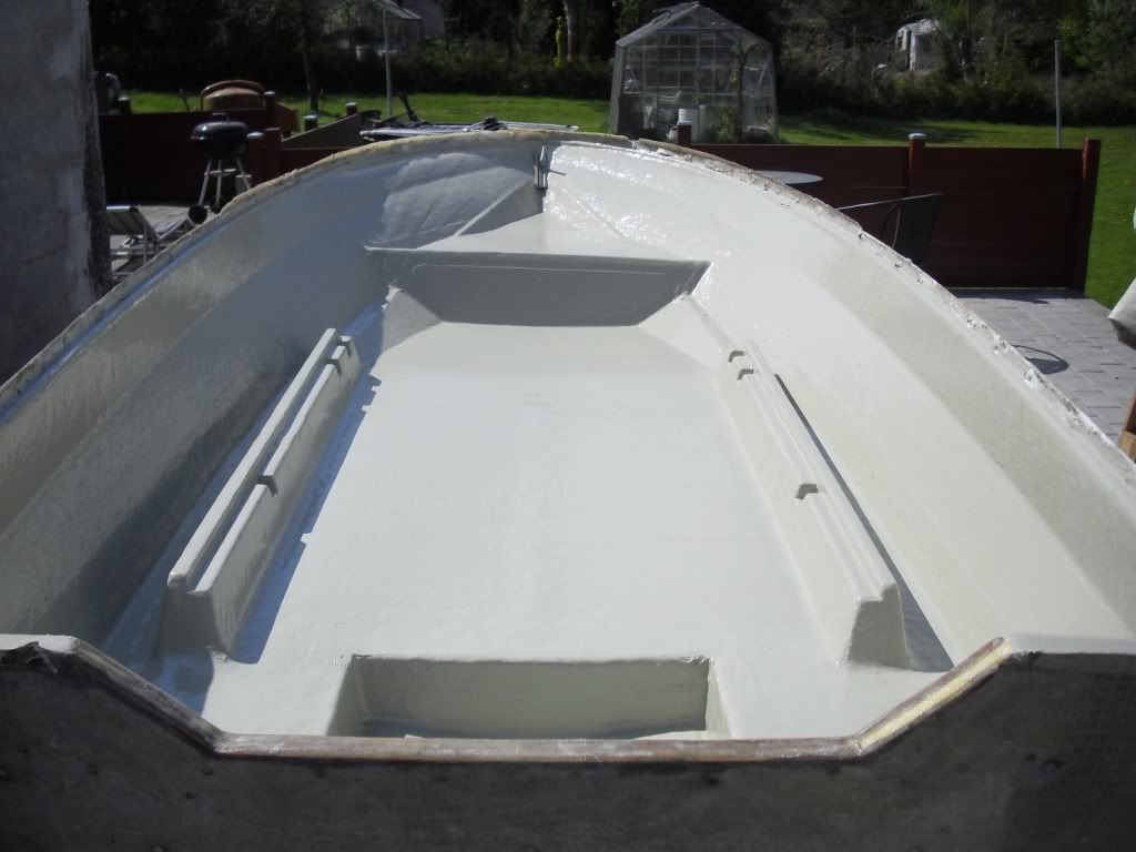

Just a small update.

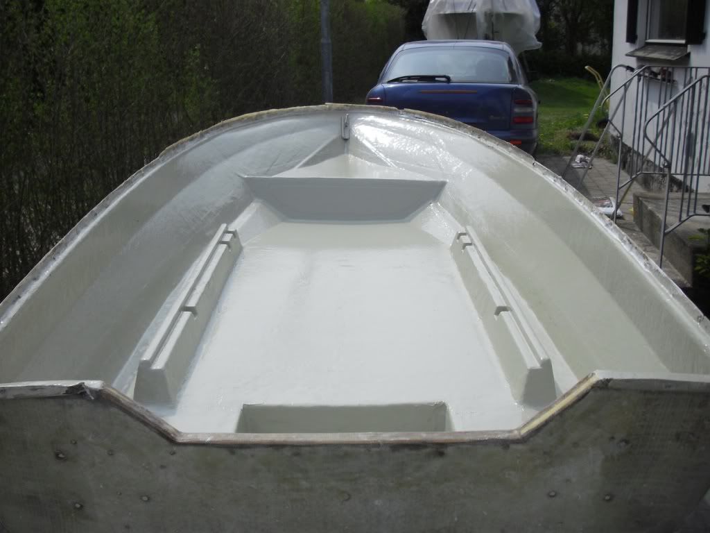

Finished applying 2 part polyurethane over the epoxy primer inside the hull. It went really well. Some really nice paint to work with, I applied it with mohair rollers, it was easy and it kind of ran together.
The result is far from perfect, due to the rather rough grinding I did, which can still be seen some places through the paint, however its acceptable to me.
Also put the top back on, tomorrow I will permanently attach it and glass in the splashwell and add two layers to the outside of the transom aswell.
Will post an update tomorrow if everything goes as planned, starting to see the end of it!
First layer of polyurethane (with a 48 hour window to the next layer).
Second layer, no point in adding more layers imo, it covers everything good.
Yay the top still fits :)

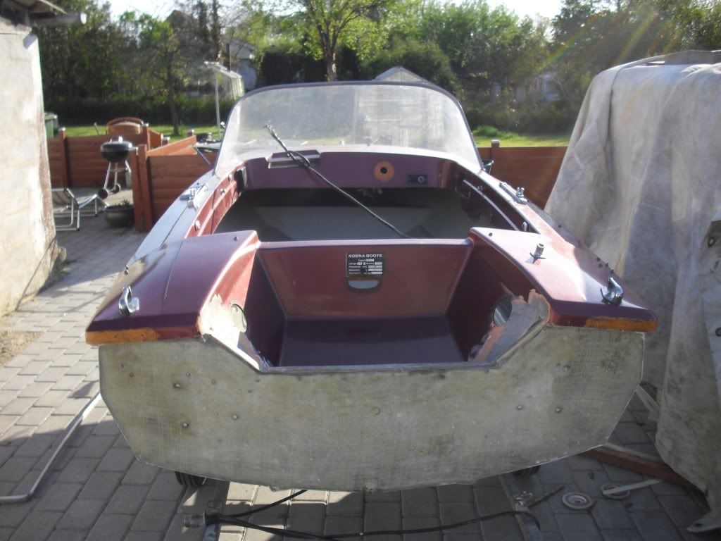

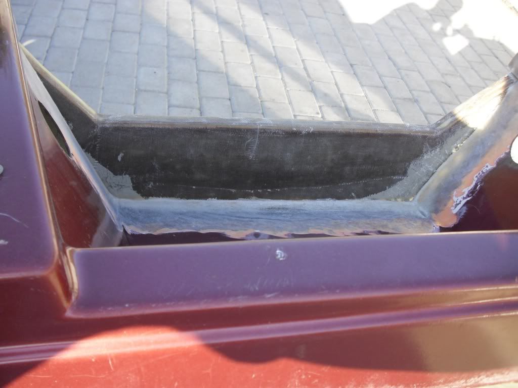

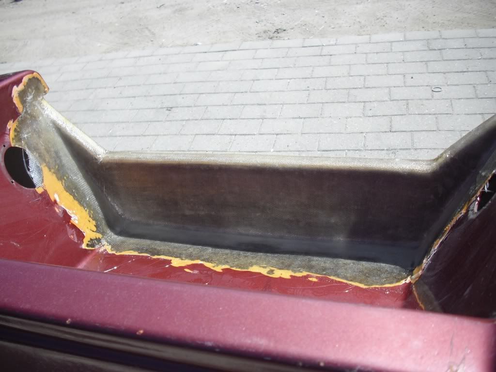

Another sunny day, and a little more work getting done.
Top was attached to the hull using rivets, as that's how it was attached when I took it apart and it was easy to deal with.
Splashwell got attached to the inside transom with 4 overlapping layers of woven rowing (1 layer going over the top to the outside). Then two additional layers going from inside of splashwell curving over the transom and covering the entire outside of the transom aswell. All 10 oz woven rowing with epoxy. I wanted to get a few layers on the outside due to all the former holes I closed with epoxy putty earlier, so I got a completely closed and strong surface.

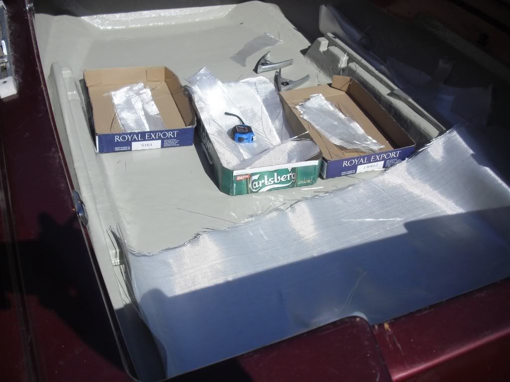

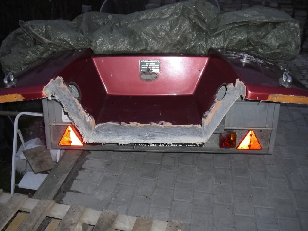

Next up wait for epoxy to fully cure, then grind and paint with 3-5 layers of epoxy primer (on outside transom), paint with polyurethane above waterline.
While waiting, I have seats to finish, new steering and other small stuff.

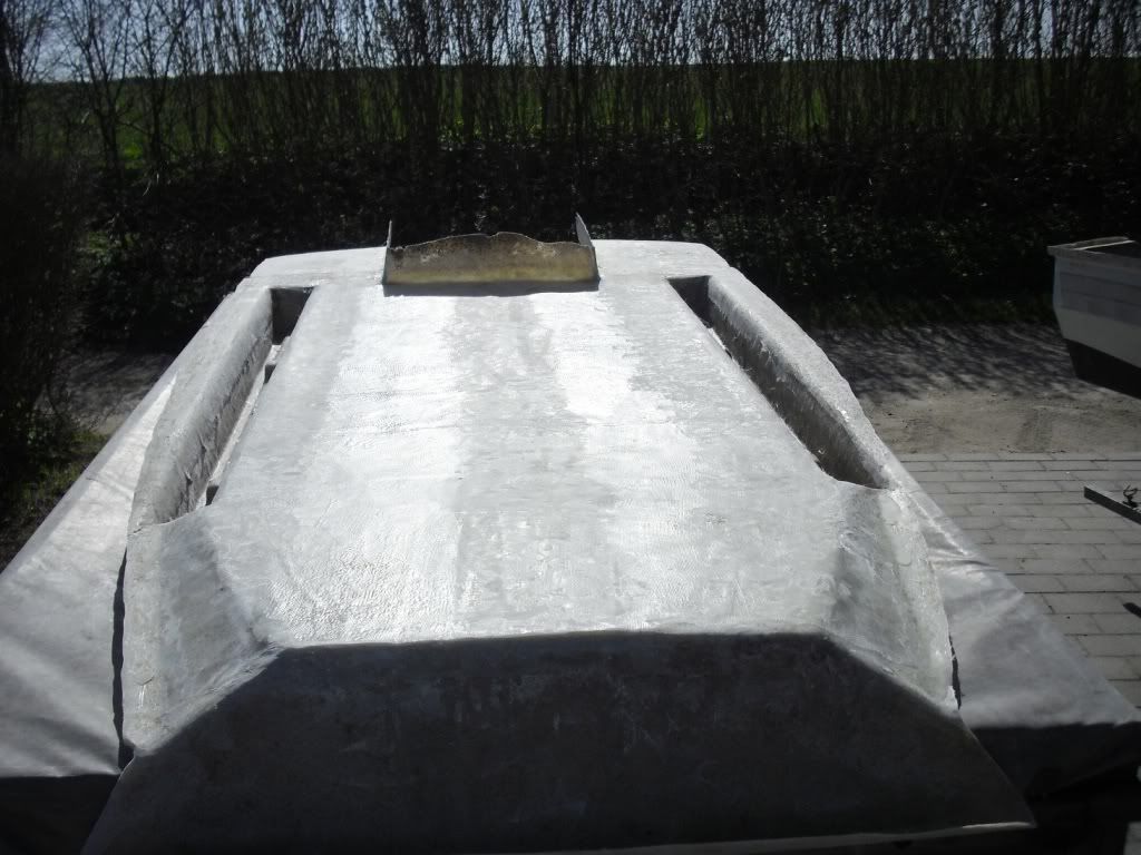

All fabric cutout and ready to go on (left, middle, right side of transom/splashwell and the big ones for complete overlap).
Splashwell epoxied, with 3 layers inside and additional 3 layers from the inside to the outside.
Outside transom got two complete layers. Used foam roller to even out the excessive epoxy well, so hopefully when I grind and paint there will not be much print through from the fabric.
