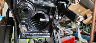

The picture I posted shows where your shift cable adjuster is (right) and the arm In front of the exhaust bellow is what contacts the dog in the lower unit to change gears.
Might have to adjust the shift cable because it is very critical on these.

The shift problem could be the bellcrank is bent???
The pic above shows the bellcrank.
Take it apart and see if the part that is inserted in the housing is at 90d???
