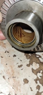

Hi,
It is apart right now because I have excess longitudinal play in the propeller shaft 3/16" and it jumped out of gear on me once.
I did come to realize about the shift rod height adjustment after researching so that may explain the jumping out of gear but I want to fix the play issue.
I may get a new reverse gear but I can't afford the forward/pinion setup. The gears themselves look fine but the bushing in the forward gear is not worn evenly, evident by the lubrication groove depth. I am going to replace whatever I can just to upgrade so to speak.
I'm going through the drive like the rest of the boat 😊
