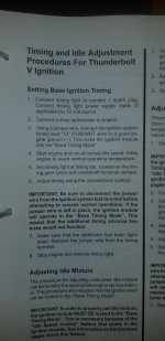

Ok got the info on the base mode and will do it soon. I have to redo the idle mixture and idle speed in base mode
gica
Feb 24, 2016
582
I did the Base timing check and in my opinion it's right on 10, manual says 8 though but close enough see for yourself. Also there is a picture included with the purple white wire. I will redo the mixture at 1 1/4 and set idle at 650. The speed has to be done in the water I think.
