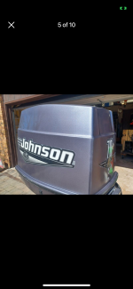

Do we have any pictures?
Questions to ask, does it run and if so does it run well? Why are you selling it? Anything I should know?? Does that make them nervous?
Last but not least, is there any corrosion?

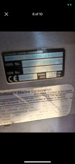

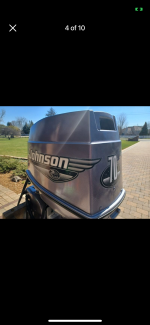

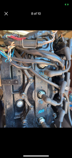

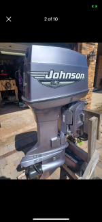

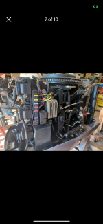

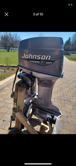

Nothing really specific for that particularly fine running model.

If a compression test is good it should be last for many years.----Install a new water pump impeller if you become the proud owner.

Iknow looks don't count but with that compression ...if accurate that engine certainly looks like it was given lots of TLC .

I don't think I'd ask any questions, I would just get my money clip out of my front pocket and give him a whole bunch of Ben Franklin's.
One side note though looks can be deceptive!!!😆😆😆
