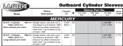

Hi All,
A screenshot from the LA Sleeve catalog attached suggests there are 2 different sleeves for the manufacturing years my 2000 90ELPTO outboard (made in Belgium, serial #0P121707) falls into:
- L130OB (short exhaust port notch): 1994-2014
- L167OB (long exhaust port notch): 1998-2014
It even explains how to measure the current ones to figure out which spare ones to buy. The problem is that the outboard would clearly need dismantling to take those measurements, which I hopefully won't have to do in the foreseeable future as it's running fine. Does anyone happen to know which of these sleeves went into which outboards over those years - basically anything that could give me a hint which one is more likely to have been installed into my outboard when it was made? I'd really like to buy 3 ones that fit before LA Sleeve stop making them. Unfortunately neither LA Sleeve nor Brunswick Marine (basically "Belgian" Mercury) were able to tell me which ones I need.
Many thanks in anticipation!

Gee, re-sleeving is usually a last ditch effort. Why not price oversize pistons and plan to use those for when you damage your bores?
39,775
Buy 3 of the short ones.-----Make them long if need be.-----Agree with above post, boring the existing sleeves for O/S piston and rings is so much cheaper.-----

Thanks for your replies. The OB is actually running fine still on standard size pistons (although the compression is on the weak side of it) and surely I'm going to re-bore it into the 1st oversize when the time comes. The sleeves are more of an investment into my own peace of mind and happiness really, although tbh a lot of spares that I bought in late 2000s just in case with the feeling that I may never actually need them turned out to be a pretty good investment like into the fast growing stocks looking at the Mercury parts prices these days ) The other reason to consider buying them is to have genuine LA Sleeve ones while they're still made: sadly parts quality only goes down and down globally... Good idea about making long notch ones out of the short notch ones: I had it too but didn't realise it's actually possible. In fact I feel the short notch ones would be the right fit anyway as the long notch ones are a lot rarer for some reason. It'd still be nice to learn the history behind them both.
It's all down to pricing and availability: no rush at all. I first tried getting them back in 2017 and just couldn't work out a cheap enough logistics to ship them internationally and gave up.
