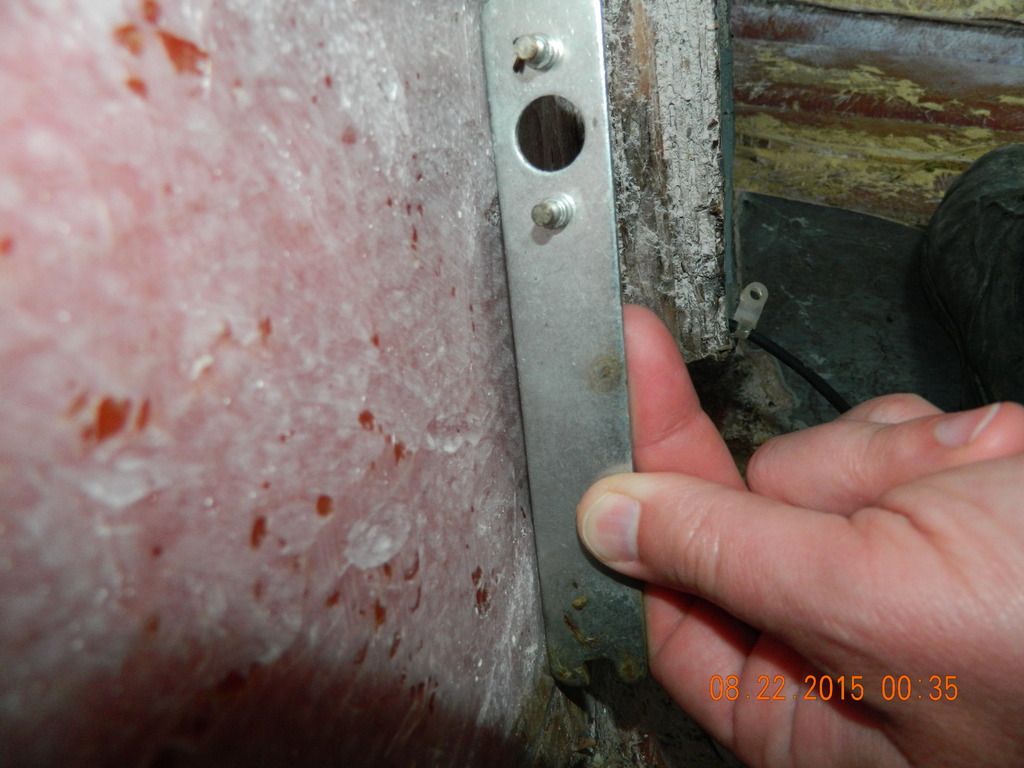

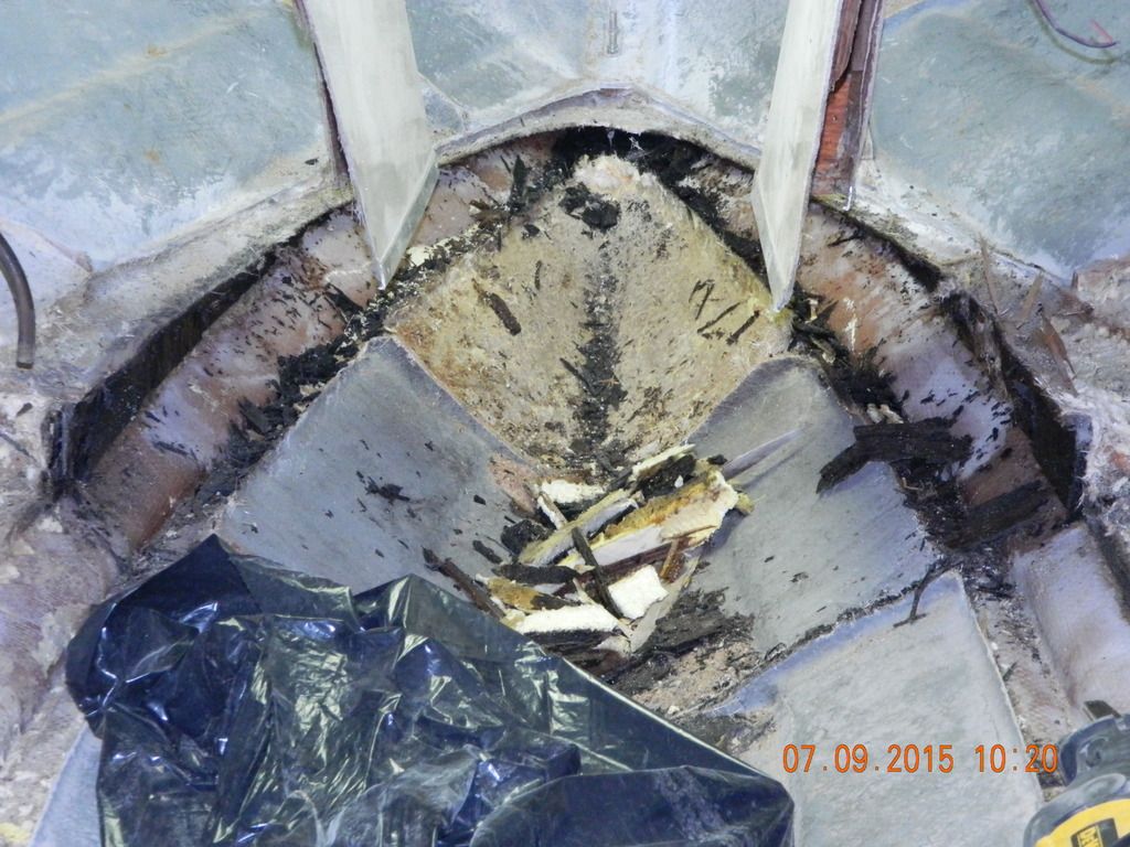

Yatch Dr. - I was thinking of going with 2 rows of plywood stringers (staggering 4 stringers like you mentioned) but I think that will be difficult because of the hull shape. So, I will just go back with Bayliner's design. I was able to get the rest of the stringers out last night. I'm glad I listened to the advice to keep going. All of the stringers up front were wet and rotten. All of the black that you see in the picture below rotten plywood.

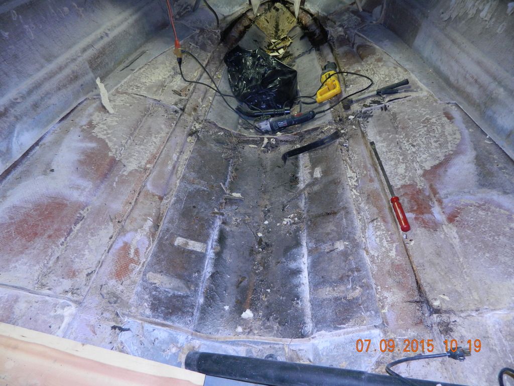

Now that I have all of the deck, stringers and foam out I'm going to start grinding.

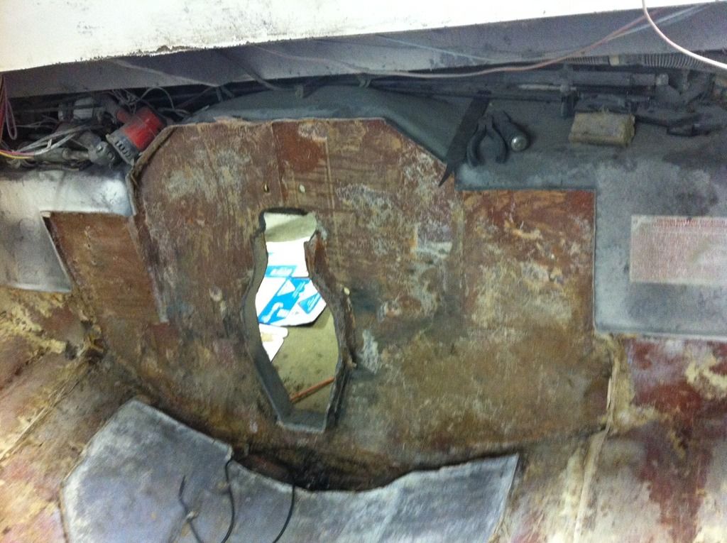

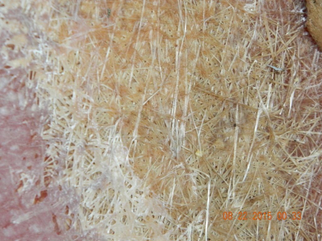

Ok. After a vacation and some other chores I have been able to get a little more accomplished but I need some help. Here is what my transom looked like before I started grinding.

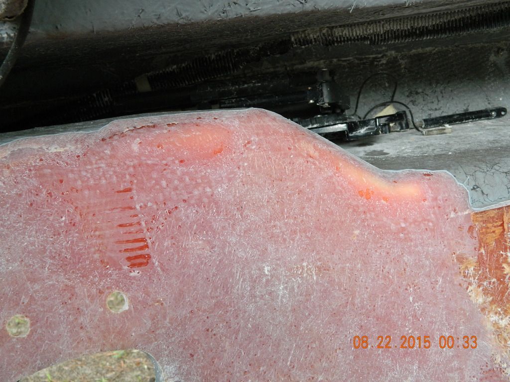

Here is what the fiberglass looks like up close.

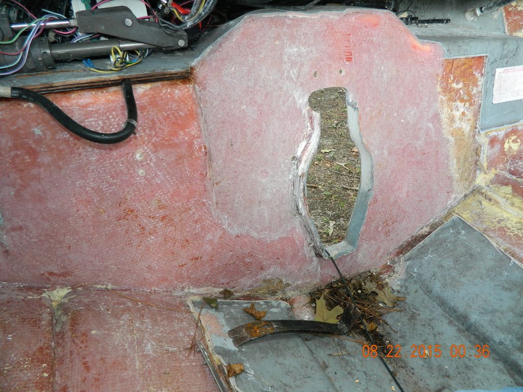

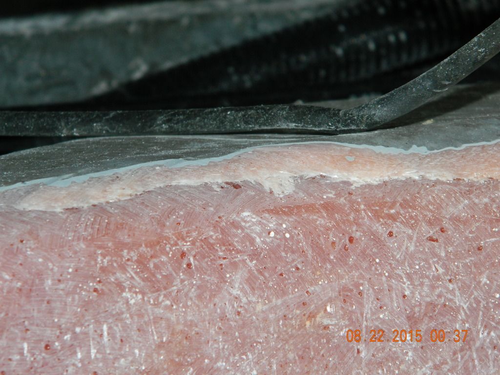

Here is a wider shot of the transom. The glass on the left side is lighter in color because I took off more material. I felt like I was getting down to the good fiberglass.

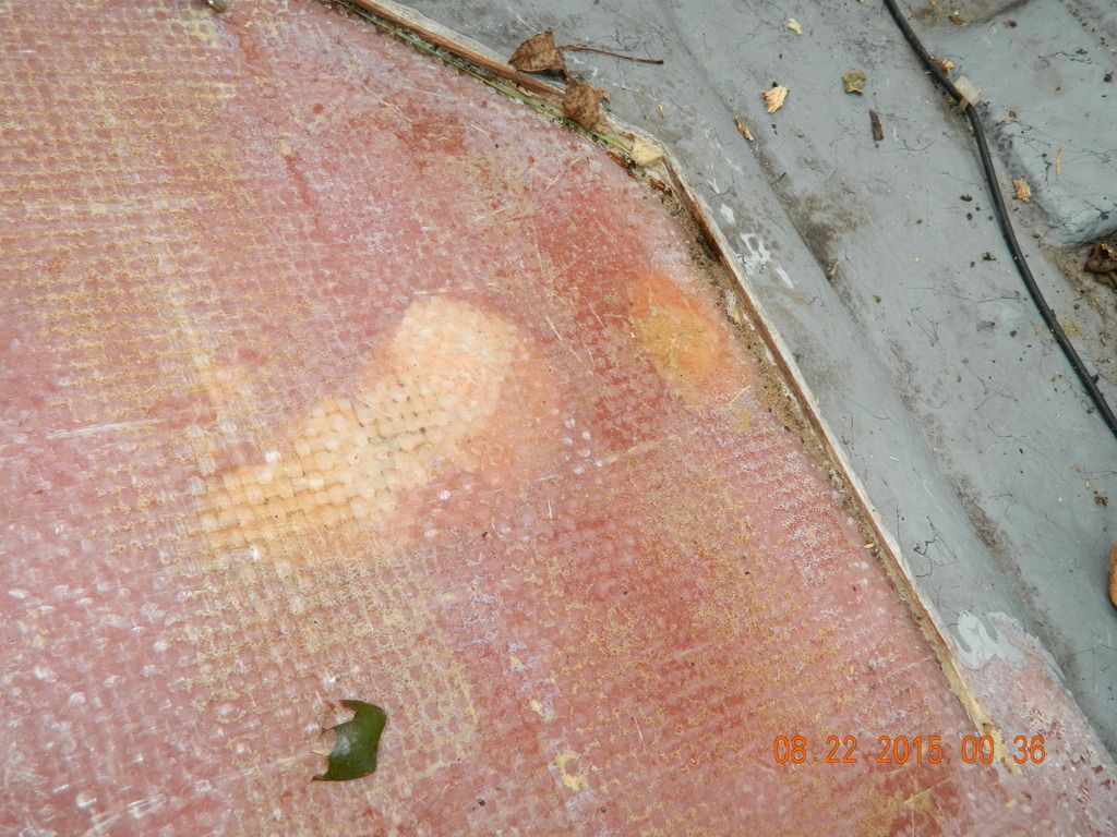

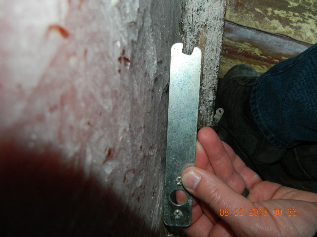

This is right above the transom where they tabbed in the wood. Do I need to grind this down?

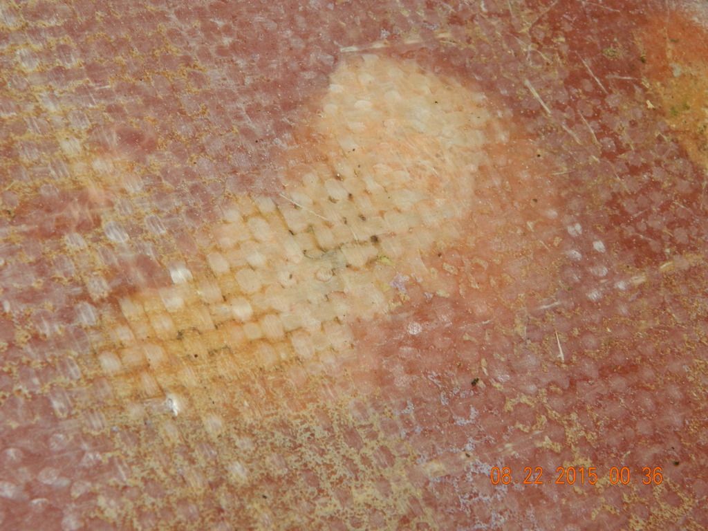

Here are some suspicious spots on the bottom. This is under the starboard engine mount.
close up

So, here are my questions.
1. Am I going too deep? (post 27)
2. Do I need to build it up before going back with the transom? (post 27)
3. If I build it up, how do I keep the thickness consistent? (post 27)
4. Do I need to grind at the top of the transom to get the "air pocket" out? (post 29)
5. Do I need to grind the weird spots on the hull? (post 30)
6. If so, do I need to build it up to flush with the rest of the hull? (post 30)

The MFG sure didn't do their best work on the outer skin of your transom. If it were me I'd mix up some PB and spread it over the rough and uneven spots using a broad putty knife. Doesn't have to be perfect but just to get her somewhat smooth. When the wood core gets clamped back on with additional PB it'll fill in any left over voids and low spots and flatten everything out. It'll all be back better than the factory boys did.;)
Thanks WOG!
