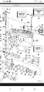

I'm not putting down an aftermarket LU. I've read both good and bad things about Stern Drive. I just want to get this over with and identify the lower unit that is on my engine. LOL in all honesty all this research has taught me a lot

The reason for this thread was trying to identify what LU is on my engine.. Original LU for my J2000 has internal water screens.

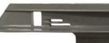

Your original unit(batwing) had bolt in plastic inlets. The one you have on there now has cast inlets with plastic internal screen.

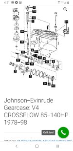

So to clarify>>>
"The easiest way to tell if it is a 60° V-4 motor is the pan mounted trim switch is on the port side."
Also you're saying my outboard uses many years LU's
If/when i need to order maintenance parts what year do look up?
Thats where my confusion is
39,223
You can not identify motors by a trim switch.---They did not make a crossflow 90* V-4 in 2000 model year.-----Your lower unit could be from about a 78 to a 98 model 90* crossflow.-----You will see that impeller is the same for all years.----Seal kit is the same part # as well.
