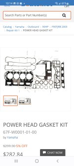

Mercury is making a lot of the parts for "their" early carbureted 4 strokes obsolete. These engines were a joint venture between Yamaha,and Mercury using Yamaha powerheads this lasted from mid 1995ish to around 2005ish. It ended in a lawsuit as I understand. You may have better luck,and pricing if you can source your parts through Yamaha.
Mercury no longer supplies the engine rebuild gasket kit for your engine. When they did the last price i can see was around 500 canadian for it. Another example of this would be (1) of your carburetors from Merc that is still available is around 800 canadian. Yamaha is around 250 USD
Also before you tear into your engine make sure you start with compression and make sure water in oil isnt from tstat stuck open,or extended trolling.
