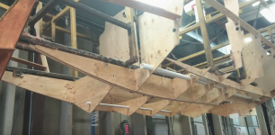

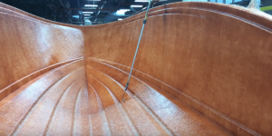

Here is a Sea Ray factory video that shows how the boats are made.
It is from a slightly newer era than your boat, but their methods look traditional. At one point they talk about coring in the cockpit/deck mold, and they state there is no coring in the hulls.
Here are a couple of photos from the video. (attached below)
You need to determine if behind the damaged area there is an open compartment (i.e. storage area) . . . or a foam-filled chamber.
Post some pictures from the inside if you can.
