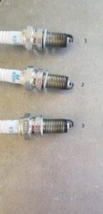

Good morning Chris1956! OK, the comp test showed #1-130, #2-130 and #3-140 and attached is the pix of the plugs (they don't look too bad) let me know what you think. BTW all 3 carbs jets were ~2 1/2 turns out.

Compression is good. Spark plugs look good as well. Does that motor have an accelerator pump? Does it work?
