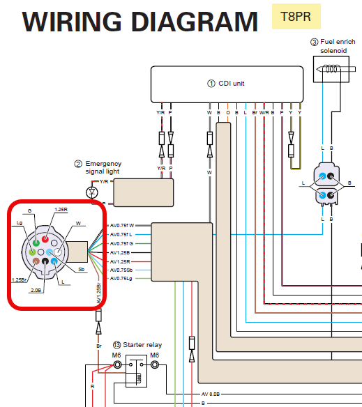

Here is what I'm looking at.

The motor has been modified. It would have come from Yamaha with a ten pin connector on the main engine harness. That connector would have connected with a corresponding 10 pin connector in the ten pin wire harness.
