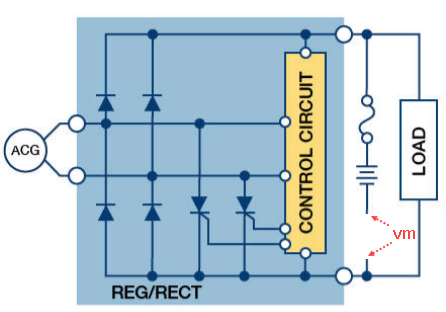

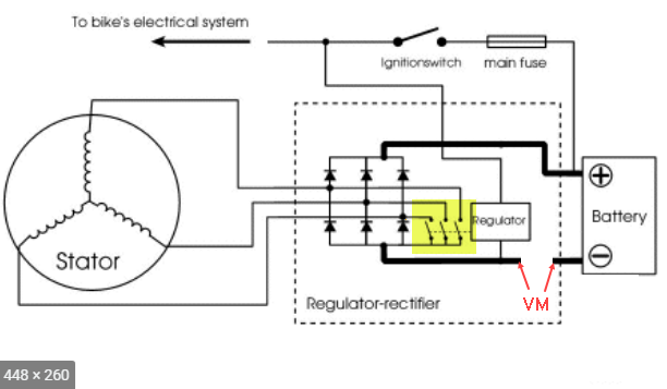

Is this a two wire R/R or a three wire R/R? Input from the stator assembly that is.
boscoe99
Aug 22, 2013
2,412
I just tested my two wire R/R. Volt meter between the disconnected black wire and the battery ground. VM indicated battery voltage.

That makes sense. I wish I could get this one to read 1 volt or less but 12 volts apparently has something wrong or shorted somewhere. I also installed new battery cables from the battery to the motor. No other wires are connected to the battery.
boscoe99
Aug 22, 2013
2,412
I am also seeing 12+ volts from the R/R on the black lead to the battery on my three phase R/R.
boscoe99
Aug 22, 2013
2,412
No. The output is just fine. On both of them. Three of them actually. I just tested another two wire input R/R.
I never gave any thought about voltage being on the black ground wire until you brought it up. Current is just a few milliamps. My guess it is voltage through the regulator control circuitry.
