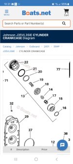

Sticky occasionally Thermostat or other part in the thermostat compartment. Gasket or spring ? Remove the thermostat completely. Just leave the cover plate off the motor. Start the motor. Check the flow rate coming out of the thermostat housing hole. Just a quick 1 second of WOT speed. Should spray water ALL OVER the place. If flow is terrific ? Buy OEM thermostat, spring and gasket. You must install the parts in the right order. www.crowleymarine.com has great drawings to show reassembly.

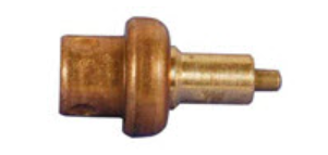

I pulled the thermostat assembly apart. Found this loose pin. See pic. I put the brass thermostat in my vice and applied heat to the button end and observed no movement. The nipple coming out of the thermostat is like black in color and flexible . I don't see how the tip that is loose connects to the thermostat

Is that tip supposed to be attached to the thermostat? Would that make it stick closed?

Those pins are NOT NOT always shown in parts sequence models. Call or go to a place that does Evenrude repairs. DEalers really have those pins for sale.
Can not remember which motor had the pin in it. Might have been used to allow some water to ALWAYS pass thru a cold engine to speed up circulation. I could not find a hole to put it into. Dealer might need the model number to be sure what you will need....That engine has a ton of parts in te thermostat housing. www.crowleymarine.com was my reference.

So the black flexible tip on one end of the thermostat is normal?

You need a dealer with a mechanic to help you. That is the same parts list I saw and used. Maybe a DIY person took yours apart and forgot something. Or added a extra part. Call my local Evinrude / Johnson place. Ask for Butch. will be on off season days / hours. 1-315-686-5622
