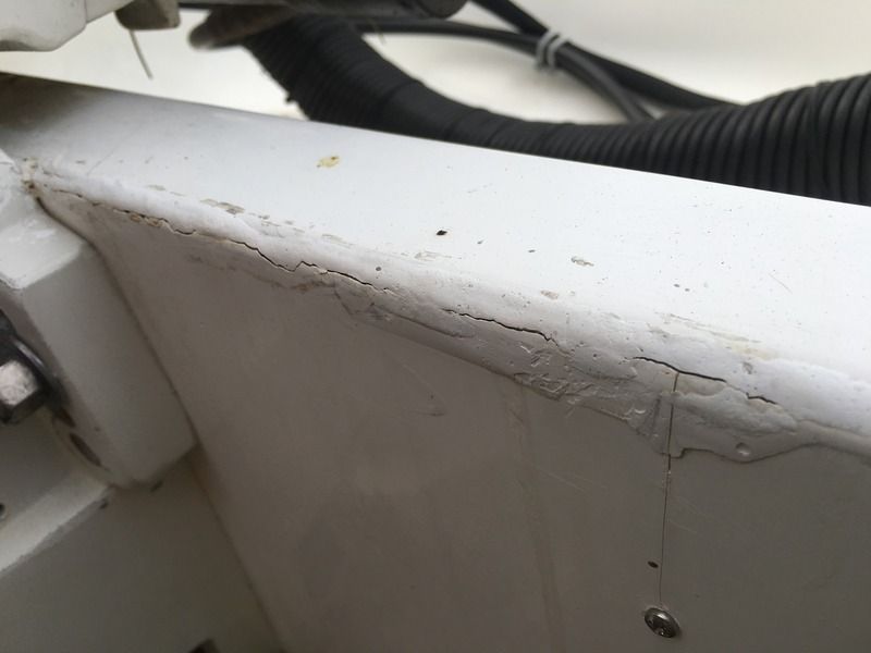

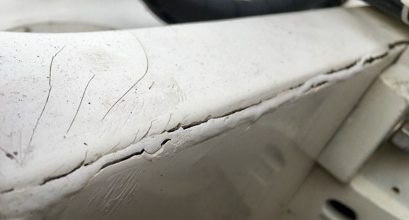

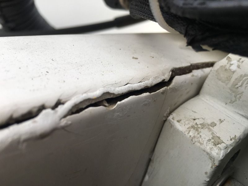

Well, I'm looking for some advice. There's a crack running horizontal across my transom. I've replaced wood transoms multiple times, but never one of the composite type.
From looking at the pics you can see an attempt was made to either repair or cover up the crack (previous owner). What I'm lost with is what all is entailed with working on this type of transom material? Is it a gut and replace or perhaps something else entirely?
Any info is appreciated. Lemme know if you have more questions.

Crazy delayed bump, so please don’t shoot... The crack in the transom is still an issue. Shortly after this post in ‘17, I took it to a fiberglass repair shop here in town and their stance was its purely cosmetic after his inspection. Ultimately, he recommended me to get a piece of metal fashioned to cover the top of the transom and let it ride. I was never comfortable with just covering it up, but I haven’t exactly had the time to remove the motor and get to work on repairing it either.
Expanding on my original question, I see now it wasn’t exactly worded great. What I really wanted to ask is when dealing with composite material in the transom, is it required to do a full transom repair as I have done with wooden transoms before? Is it possible to just grind down and open this crack enough to build it back with glass?
Any assistance is appreciated!
Ayuh,..... Step 1 is to pull the motor, 'n identify what the composite is,....
