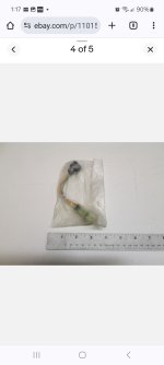

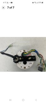

Yes round connectors. I had to get these adapters shown below. Tach and oil status work fine.

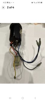

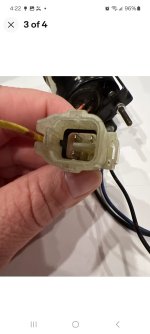

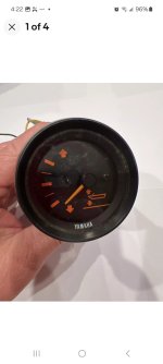

boscoe99
Aug 22, 2013
2,319
That looks to me like a trim gauge for an older three wire sender.
Ground the gauge on the black wire and apply battery voltage to the yellow wire. Then measure the orange wire and see if it reads 5 volts.
boscoe99
Aug 22, 2013
2,319
Three wire senders interfaced with three wire gauges. With the third wire being voltage provided by the tachometer. On the orange wire.'
If you look at your tachometer you will see the orange wire. With power and ground applied to your tachometer I suspect you will measure 5 volts on that orange wire. That 5 volts was used to provide the trim sender with voltage.

Looking at part number Yamaha 6Y5-83670-12-00
States 2 wire sender guage. Do I still use my existing harness to go from motor to guage? Harness has an orange wire in the 4 spot plug connector.
boscoe99
Aug 22, 2013
2,319
Damn. Yamaha is proud of their stuff.
That gauge should work. Won't be plug and play however. You will just have to figure out how to get the pink wire from the sender to the harness and to the gauge.
The orange wire won't be in use.
