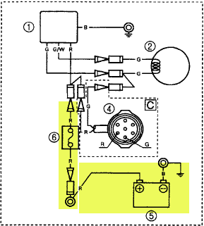

Has anyone a clue were this wire goes. I'm either really blind or something. I didn't pull it off
J Jakem Lieutenant Junior Grade Joined Apr 25, 2021 Messages 1,097 Jan 21, 2022 #1 Has anyone a clue were this wire goes. I'm either really blind or something. I didn't pull it off Attachments 20220121_160851.jpg 1.9 MB · Views: 11
B boscoe99 Commander Joined Aug 22, 2013 Messages 2,232 Jan 21, 2022 #2 What is the full model of the motor?
J Jakem Lieutenant Junior Grade Joined Apr 25, 2021 Messages 1,097 Jan 21, 2022 #3 T9.9 exhz 6g8x 790362
R racerone Supreme Mariner Joined Dec 28, 2013 Messages 39,450 Jan 22, 2022 #4 A red wire with a fuse usually is part of the 12 volt supply to a ignition key switch.
B boscoe99 Commander Joined Aug 22, 2013 Messages 2,232 Jan 22, 2022 #5 Service manual shows that wire going to a battery.
J Jakem Lieutenant Junior Grade Joined Apr 25, 2021 Messages 1,097 Jan 22, 2022 #6 Got it. Thanks guys
R racerone Supreme Mariner Joined Dec 28, 2013 Messages 39,450 Jan 22, 2022 #7 Item #6 would be the fuse.-----Found inside the black rubber plug.
