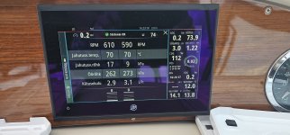

So! 3 trips made and it seems to be fine now.
What was done and what fixed it - I have no F***ing clue:)
New valve springs, heads done, all new gaskets, left and right side heads were swapped, new manifold. Engine is running better and not so big difference between port and stb engine anymore on power of consumtion on idle or under 3800rpm. I do hope that all is good now and this summer my main concern is petrol price :) Thank you for your support!2025-05-28 16.23.19.jpg

It was checked as well - and was OK. Consensus here seems to be linked to dead valve springs - during 3000 rpm excaust valve stayed mostly open and overheated that one spot, when cooling down with sea water, it made it crack
All manifolds were faulty in the same spot.
I do hope that it will now run smoothly for the whole season:)
