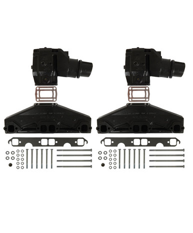

Also, no need for OEM manifolds and risers but I would shy away from any aftermarket other then Barr. Will be about the same price as your AZ special.

If you have to replace the exhaust system do NOT buy off brand stuff from Amazon, if that joint between the elbow and manifold leaks because of poor machining of the cast iron you will have water in your cyls and a possibly ruined engine. People used to have a lot of trouble with GLM exhaust because of this, they might be better now, but I heard bad things about them from a marine mechanic I know well and a guy I get my parts from won't even order them. The only aftermarket I'd use is Barr Marine. I installed a set on my Cobra 8 years ago and they are still good (this is good for salt water use!) and it all fit right with no leaks. And you definitely should check the flatness of the mating surfaces with a straightedge and feeler gauges (less than .003" variation).
52,778
I will also add, the chinese amazon specials that you have listed are more expensive than Barr manifolds which are OEM quality. I only recommend Barr or Osco. I do not recommend amazon chinese manifolds.

Check out Lighthouse Marine in Riverhead Long Island that’s where I got my Barr exhaust. I can save on shipping (heavy!) because it’s about a hr drive from where I live. But first see what you have. If this boat was used in only fresh water the system night only need cleaning of the passages and re-surfacing of the mating surfaces w/new OEM gaskets.

do not use amazon for junk manifolds

Also found the Barr Mani and Risers here
A little over 1119 + 50 shipping... and also there's an option to pay using Amazon so hopefully at check out I can use the instalment plan. I haven't placed the order yet because I just got the boat in the driveway and there are 2 different exhaust sizes 1 is 4" and the other is 3 3/4" so I need to measure to see which ones I order. Will pull a riser tomorrow and post pics also.
