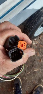

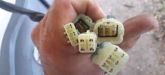

I'm re powering a boat with a 2003 Honda BF50.
I bought a new 20 wire main cable for the Honda. The one that is on it ,I now discover, only had the main round plug wires and not the addition plug on the new cable with 6 wires.
Also the control side of the cable is completely different from the new cable.
To make matters worse, neither the attached cable or the new one I bought seem to match
the new side control I bought.
So I'm completely stumped.
Ive attached the engine connection and the other end of the cable in the first two attachments.

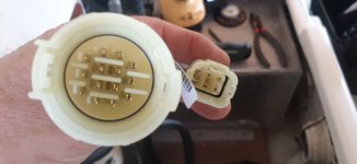

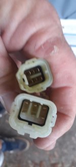

This is the new cable (not yet installed). It has the extra plug that I dont see on the old one. The control end is completely different.

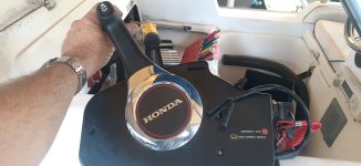

And here's the connectors that I have on the side controls.

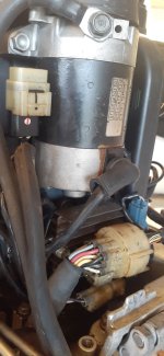

Finally so you get to see exactly what Im dealing with heres the new side control. I bought it locally. I have no idea of which model number it is. I dont know where on it to look for a model number.

Well, here's one hint. Not all of the plugs are generally used!
The big round plug on the motor end is all you need most of the time.
The wires shown in the picture of the side control are generally extended and used for a tach. Hopefully (if you have the correct control) there's another set of wires coming from the control not shown in the pic. USUALLY, this other set of wires is just matched up to the forward end of the harness. At that point you should be good to go....

The wire plugs from the side controls (pic 5) match two of the plugs from the forward end of the 20 wire harness (pic 4) except that the wire colors are not matched. Sorry I thought I'd said that.
If the colors matched pin to pin I'd figure that s how it goes. They do connect together securely.
I also figure the other 6 pin plug next to the round main (pic 3) isn't needed or attaches to something I'm not seeing/ not on motor.

Can't say that I've noticed a difference in wire colors matching the harness to the controller.
I'd be tempted to try it. Worst case, everything is run through the 10 amp fuse located next to the starter. If the tilt works and the motor turns over, you should be good to go. Next concern is the choke.
That LOOKS like a newer controller. The issue being whether or not it contains the manual choke switch for the motor. That would be engaged when the idle up lever is all the way up against it's forward stop. The newer series controller for the 06/07 and newer, don't have that choke switch, because those motors either have an automatic choke, or they are fuel injected.
No huge loss if the control doesn't have the choke function. That just gives you an excuse to mount one remotely on the dash (or wherever) that's generally easier to use anyway. Horn buttons work great.
On the motor side, don't worry about where the extra connector plugs in. If your motor has a place to plug the extra lead in, it would be to an extra cable laying right next to the big round one.

Like I said. Those two plugs do fit but the wire colors dont match. Mind you that's the new 20 wire (14 round) I bought for the motor hoping it would match the remote I had to buy. So in other words. New 20 wire and new side control match connectors but not the wire colors. And the wires colors are not just mismatched colors but also different colors
The 14 wire round harness that WAS on it had completely different connectors. The guy before me had it connected to a OMC top mount remote that I cant use. All the pictures are posted I think.
The wires on the main round plug on the old and new cables match wire for wire.
It's the control end connectors that dont match up.
Looks like the main round plug has never changed. The plugs on the other end of that cable have.
It could even be that I have a 20hp side control and not the 25hp and up. Like I said I cant see anything on it to tell me what control it it.
So yes the plugs match from the new main harness to the new remote but the wires in the plugs dont. The plugs from the one cable have some different color wires than the other.

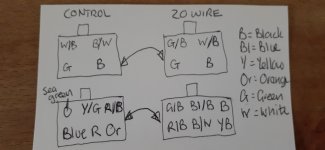

73 Dolphin
Oct 8, 2008
309
Apologies for the crappy drawing but... the connectors on the left are from the side control. They are the 4 and 6 pin connectors....
On the right are the connectors from the main wiring harness.
They are drawn the way you see them looking at them. So they are mirror images.
So the 6 wire control to main when connected goes like this...
Sea Green (not green or blue) connects to black.
Blue/ Black connects to Yellow/ Green.
Red/Black connects to Green/Black
Blue connects to Yellow/Black
Red connects to Black/White
Orange connects to Red/Black.
(like I said - not even the same colors)
The 4 wire:
White/Black connects to White/Black
Black/White connects to Green/Black
Green connects to Black
Black connects to Green.
(this has almost the same wires just located in different places)
It's a new main harness model number listed somewhere above and a new unknow model Honda side control (picture also above)
It's not that I don't want to get my hands dirty - I removed the 40hp yamaha that was on the boat and replaced with this motor - I just don't know where to start with what I have here.

ahicks
Sep 16, 2013
3,957
Well, not good news. I have no clue what you have going on. I checked 2 different used harnesses that I have here, and a used late model control (no choke, 4 idiot lights) and none of them even come close to what your diagram is showing. The 4 wire doesn't match either side (control or harness) and same story with the 6 wire.
The orange wire sticks out like a sore thumb. I don't remember seeing an orange wire.
One other note. That control looks like a Chinese knock off sold on ebay. I've never tried using one.
73 Dolphin
Oct 8, 2008
309
It's not a Chinese knock off. Like I said it may be a 20hp remote which I'm guessing has different wiring as the controls and 20 wire harnesses are listed to 20hp then again from 25-250hp. (2 different types although the bodies are identical on the control boxes it seems) If so then yes the colors will be off. The orange wire is on the control wiring not the main harness. The 20 wire is the correct cable per Honda. So it looks like I have a 20hp remote and a 50hp motor. Like I said, there's nothing I can see on the remote to tell me what model it is.
There is a guy with a 50hp remote locally that's still in the box. I guess I need to go see him with my 20 pin and see if it matches.
