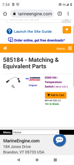

I didn't have your model number but it's your year and your hp. Need to check model for sure. I was told BRP was still making and supplying parts. Anyhow, marine engine.com

Sorry , but he needs the one from port side !---The 2 switches are different.
Race, the parts breakdown that I looked at doesn't differentiate from port and starboard. Just says temp sensor. Where do you see that or are you just pulling our legs?

On the parts fiche for a johnson 150 #s 15 and 20 are the sensors
Wow, I went to parts first where is just list the sensors and doesn't differentiate from either side. But when you go to parts breakdown and then individual parts you get the description. That sucks! I wonder how many people have gotten screwed on that one. Also, one would think a temp sensor would be the same on either side.

One is a standard temp sensor. The 2 wire one controls the SLOW operation with the second wire.
Yes, and NASA had a sq. Co2 scrubber filter on the command module and a round one one lunar module. Engineers!
I did learn you could get the 585203 off another engine and change the pigtail but those are gone to. Only ones I found were $300 something used on eBay. Revenge of the Ficht I guess!
