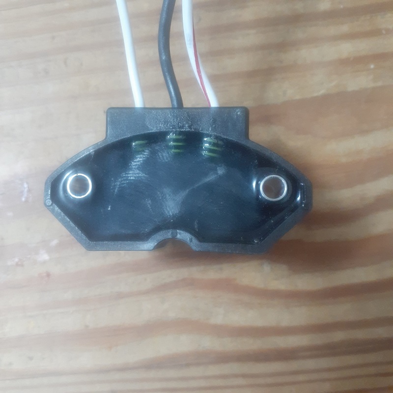

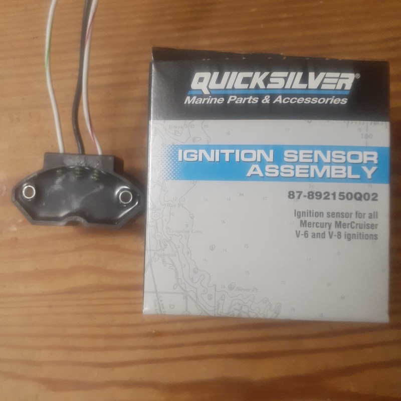

So....Got the new Ebay cheap sensors ($16.00ea) yesterday and had a chance to work on it today. A few days ago I back probed every connection for grounds and voltages...The grn/wht wire showed 4.5v even putting metal between the sensor, it would not drop to 0 volts....All connections tested good for grounds and voltages...
Today I put one of the new cheap sensors in and it fired right up!! My only concern now is how long will a Cheap one last?!
Looking at the New OEM Quicksilver sensor, it appears there are tiny springs on the bottom side not completely covered with epoxy or whatevery they use connected to the input/ouput wires...I am speculating that the sensor shorted when I first installed it and damaged it since I couldn't get it to fire...Who knows, just a guess. See photos...I'll take it back and see if I can get a new one? They might be a little finicky on electronic returns/exchanges?
So many times people don't follow up with a solution and leave you hanging when doing searches on forums. I am very grateful for the responses that kept me heading in the right direction, even though the flow chart was telling me the "New OEM Quicksilver" dist sensor was faulty....Just wasn't making sense that a brand new OEM $110 part could be bad! Hoping this response helps others with the same issue!
OH and BTW, as other reviews on these cheap sensors have commented, the hole pattern doesn't quite line up with the holes in the dist making it impossible to get the screws started....Even taking off the foam pad on the front of the sensor....The holes in the aluminum bushings in the sensor were tapered about .010" and was just enough that no way was it going to line up. I took a .213" drill and straightened out both holes which allowed the holes to line up.

Might mention it to Merc Tech support
Was the sensor bought from a major seller of Merc parts or Amazon sell everything kind of place?
And many thanks for the update
TooBizzy
Oct 23, 2009
20
I purchased it at a Mercruiser Dealership close to where I live. They had it in stock.
