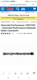

Would this cam work

cptbill
Oct 6, 2012
762
You've come this far, might as well do it right
53,272
being a GL-e, should be carbed. please confirm.
the cam I would run with a 305 would be this one:
or if you go to 350, this one: https://www.compcams.com/xtreme-mar...ler-cam-and-lifter-kit-for-oe-roller-sbc.html
available at both Jegs and Summit.
stock cam grind for the GM motor is just a step below the XM264HR
specs for the late model Marine vortec hyd roller cam used in the 5.7/350 engines. GM# 431-811658/mercruiser# 18-1485/Volvo# 3853159/OMC# 3856119.
Duration @ .050: 197 intake, 207 exhaust Valve lift in inches: .430 intake, .450 exhaust Lobe centerline
Texanatc
Jun 18, 2013
32
Yes sir. Carbed. Thanks for getting back. And thank to Alldodge as well.
