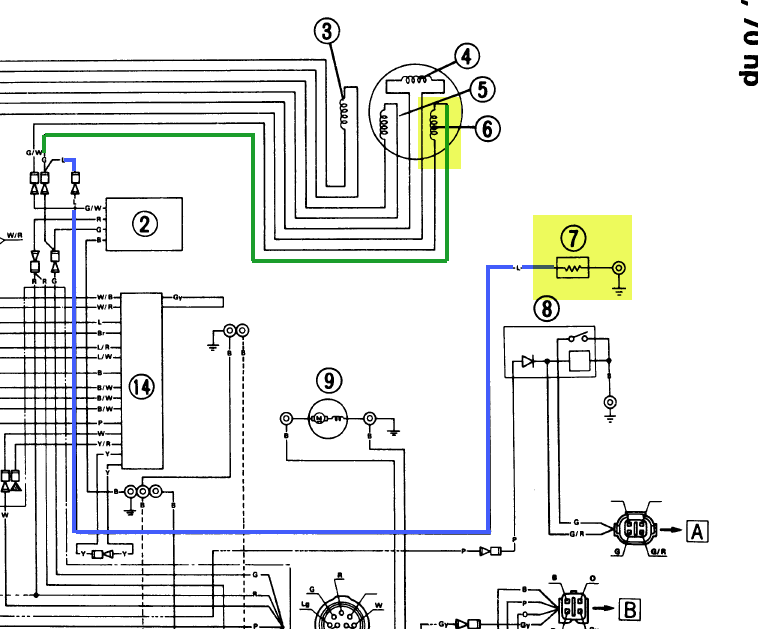

99yam40
Sep 7, 2008
9,293
should get the voltage from the lighting coil while motor is running. if the battery being charged while motor is running?
trace wires , measure voltage .
make sure the ground has a good connection

I've found the specs for the lighting coil voltages and resistances, and for the Prime Start resistance, and now have a plan of attack.
When I get back down to the boat, I shall be checking them all out to see what I can find.

YAY ! Its Fixed....
I'll put a quick description here so that anyone else with similar problems might be able to find it with a search, or Google.
Opened her up, took off the splash guard near the coils and separated the wires. Started her up and set the idle to about 1500rpm. Checked for some voltage across the blue/blue-white wires and all OK.
Moved to the Primestart and stuck a pin through the blue cable at the Primestart and checked for a voltage there. All OK - wait a minute, no it's not, yes it is.....
To cut a long story short (it took me an hour of checking and messing around). The wires come out of the coils under the flywheel, behind the regulator, then into the bullet connectors to split to the various places. When I disconnected the connectors, and pulled the wires out to get better access for checking, I found one of the wires was badly chafed and showing the conductor. It was where it went behind the regulator, and must have been rubbing away due to the vibrations (probably since new!).
I pulled the wire out and cut it, stripped back, slid over a couple of heat-shrink tubes, soldered the wires together and shrunk the tubes over the join. Just to make sure it wouldn't happen again, I wrapped some tape over the join and fed it back behind the regulator and connected everything back up.
