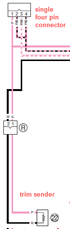

I have not been asking these questions to make your life miserable. The situation is that Yamaha made a design change around the time your motor was built. The change was related to the four pin connectors that attached to a harness that ran out of the motor and up to the dash. Early models used two four pin connectors. Later models use one four pin connector. One of the wires in the four pin connector(s) is that for the trim gauge.

The trim sender is located on the clamp bracket. A component below the bottom cowling. Find the sender and then follow the wires into the bottom cowling. Then follow those wires inside the cowling, one of which, the pink one, leads to the single four pin connector.
Let me know what you find.

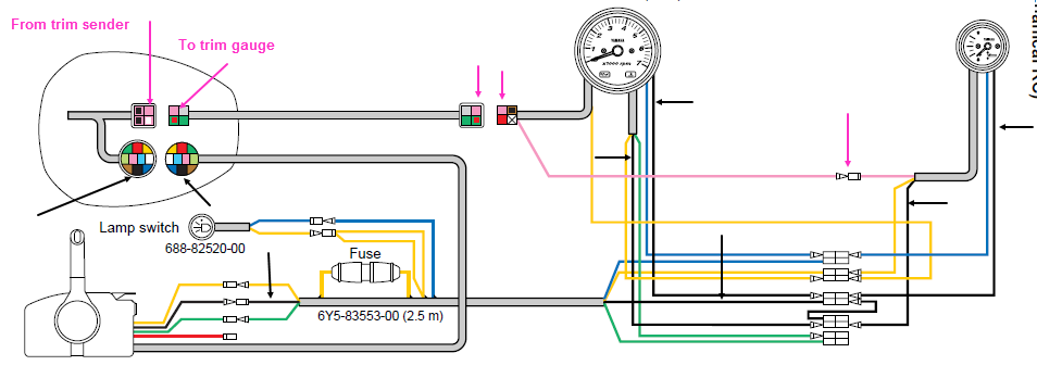

This is what the arrangement would be if a typical Yamaha trim gauge were to be used.
