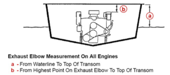

Measure the SWL to riser dimension. Should be 14". However if your boat is waterlogged, it would sit lower and promote water entering the exhaust
What is the best method to measuring that? Where is the flapper on the drive?
measure A, subtract B. should be 14 or more. if less, find out why.
here is the flapper and exhaust exit.

I will measure this afternoon and get back to you on that. I am still not clear where the flapper is and is it replaceable? Could the flapper be my problem? Doesn’t it seem strange this problem just started?

I'm leaning towards your boat has 800-1000# of water in the foam and it's riding low
52,340
If it were your boat would you just take the gamble and buy the taller risers?
No. I would first look if your existing manifolds and risers are rusted thru (acetone test) and diagnose what is needed
