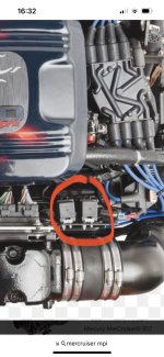

Hi. I occasionally have the exact same issue with my identical merc version of this engine. Been too lazy to fix it and only happens rarely. But it’s the fault of the wee relays on top of the engine near ecu (on mine). When I give it a tap…all is well. Reminded me to get mine sorted, reading this. Is this the relay you replaced ?
