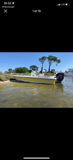

So I bought my first boat last summer. It has a 2006 Yamaha 250 VMAX 2-stroke that tested well and ran very well for the first few trips. I put maybe 20 hours on the engine, then after that, the heat alarm would turn on while at low idle. Spoke with a few guys and this was chalked up to the VMAX wanting to idle higher. Probably two trips (maybe 7 hours) later, I was on plane and cruising when the engine dropped into limp mode and the heat alarm just stayed on until I got to the ramp (about 45 minutes of screaming alarm) and killed all power. Got home flushed the motor as per usual and the alarm immediately cut on when power returned. The only thing I can think would be a problem with the external oil tank but I’m kinda lost. The boat could use a re-wire anyways so I could bypass the external oil tank if necessary. TIA.
