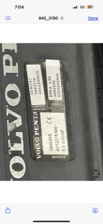

5.0GXI-GF and has 555 ECM and HSV distributor
My guess is it's a sensor that lost connection (exhaust temp, water temp, oil pressure, other) but this is just a guess. These new motors need a scanner to tell us what's happening.
If you can get it scanned for codes we would have a better time figuring it out.
