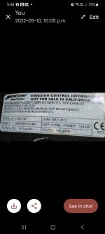

Need your engine serial number to help confirm yours has these items but you may want to try thoroughly inspecting the thermostat poppet valve and especially exhaust check valves at the bottom as they have been found to make the engine run hot if not working properly.

Talked to my mechanic and although he's never done the clear hose test he'd like to do this as now we're starting to look at engine issues versus cooling system now that we've changed everything. Anybody have a link to a good video for instructions on the clear hose test to send my mechanic?
