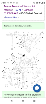

For more proof, here is the swivel assembly for that motor.
Standard tilt tube is clearly shown.
Thanks!

First I would just remove the engine steering arm to cable and verify the engine swivels on its own. Then I heat the crap out of the tilt brackets while beating on them.
Now that is what I do if the cable is stuck to the tilt tube. If the cable is froze to itself then that's easy. Unscrew the secure nut and pull it out, replace it and your golden. Some motors, depending on the boat the motors have to be partially removed to get it out. I had one break on me while I had it moored on a buoy. I sawed it off and installed a baystar steering system. (Hydraulic) For your motor is use a Seastar or equivalent.
I still don't understand why you care about the helm ....what you want is a computer breakdown of all the history. Didn't your Evinrude mechanic suggest that?
