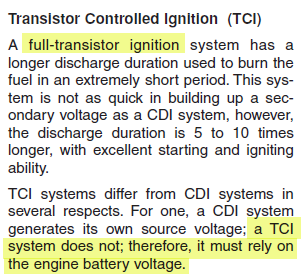

This is a 2014 4 stroke 115hp Yamaha outboard. I would think that this starts on 12v but not for sure.
39,916
Sure 12 volts is used for the starter motor.-----Most outboards today use an ignition system run by a magneto.----For example Johnson / Evinrude put an electronic magneto on the 1971 model 50 HP.----Battery was used to crank it over.-----And 12 volts was not used to make spark for plugs.
You are wrong. MOST modern outboards require 12 volts in order for the engine management computer to control the ignition and fuel injection system. All outboards 40HP and above are electronic fuel injected.
Most all Yamaha four strokes use a transistorized ignition system. Battery voltage powers the ignition coil. Controlled by what Yamaha calls the ECU. Engine Control Unit. It switches off battery power to cause the coil to fire the plug.
A relative few Yamaha four strokes, and a number of Yam two strokes, use a different ignition system. Capacitive discharge where electrical power is created by a charge coil which is stored in the CDI assembly. The CDI assembly provides power to the ignition coil to cause it to spark.
