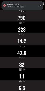

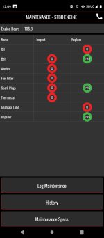

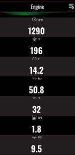

The Motor has 105 HS. I bought a Vessel View and checked. Compression Ok Start at the moment.
The problem Overheating (I just drove it to the ramp (for about 15 min) and nothing came as a fault in the system) Noticed Water Temp was around 160 degrees, Oil was old, and wanted to damage nothing.

BUT yesterday I went to try it after a lot of work completed and it gave me the SAME PROBLEM. ENGINE GUARDIAN CUT THE POWER //. I made a slow (At 1500 rpm ride / temp always at 180 with top of 230 here with the guardian)
521-20 ENGINE STBD ( ENGINE COOLANT TEMPERATURE STARBOARD )
A TEMP SENSOR CALUE IS HIGHER THAN NORMAL
The only thing that did not change was the thermostat (I tried it in boiling water and it opened at 140 degrees) I will order for a new one anyways.
And the thing was circulating water pump that I observed and it turned well but I no longer have more resource to do.
