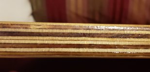

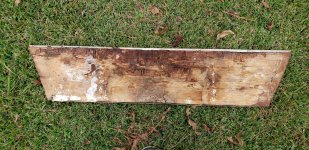

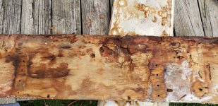

Finally got around to working on the AlumaCraft. The transom wood was completely rotten due to moisture coming into contact with raw unsealed wood.. Felt like paper and something ate large holes in it. Looks like carpenter ants. Wasn't termites. Got a new piece of CDX cut and sealed with polyester resin. Probably start putting it back together this weekend. Will take a couple of photos off it apart tomorrow. Hard to believe this thing is a 2016 model.

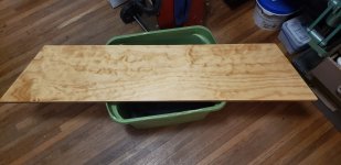

New piece of wood. For some reason they only put a 1" thick transoms board. Would be difficult to go thicker due to the brace spacing and seat modules that go all the way to the transome.

I wish I saw this thread earlier. Alumacraft and lund are notorious for this, especially the new ones. The pressure treated transom wood somehow reacts with the aluminum and pinholes form, then the whole thing starts rotting. not uncommon for 5-10 year old lund and alumacraft transoms to be completely rotted out. lund covers under warranty but not sure about alumacraft...

The aluminum was fine, but there was hardly anything left of the wood. I erroneously stated above that I put CDX in there, but it's ACX exterior grade plywood, not treated. I laminated two half inch pieces together with tightbond III and coated it with fiberglass resin. I put sealant in all the holes where there are bolts and rivets as well. I put solid rivets back where they were except through the transome wood. I don't think those long rivets were the best choice for a well sealed transome. They didn't use any sealant anywhere, just raw wood.
